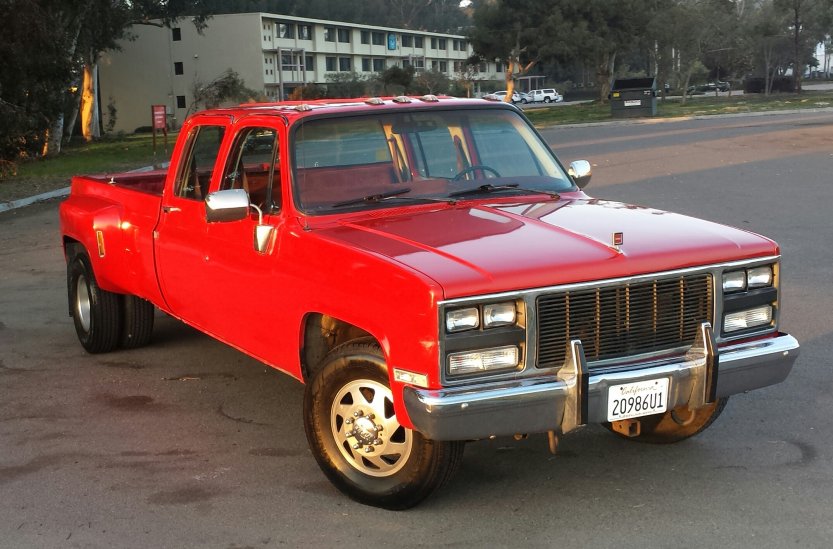

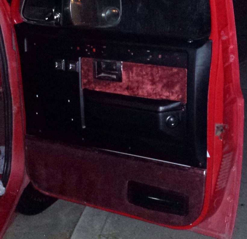

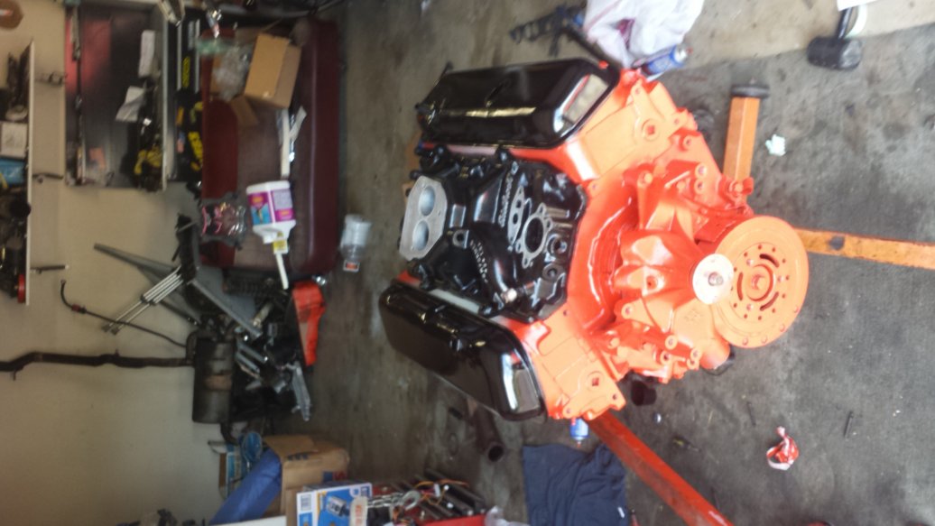

Hi I'm new from California and have been busy dumping a small fortune into my 89 crew cab dually. So far I have converted to buckets out of a suburban, rebuilt the front end, fixed alot of electrical, 3in single exhaust with high flow a high flow cat, put in a lot of sound deadening material, installed a decent stereo system, bored throttle body and aftermarket chip, and hopefully last thing for a while is what I'm currently working on is installing a motor I rebuilt. The engine is a 454 bored 30 over with speed pro hypereutectic flat top pistons modified oiling passages ported stock heads with stainless steel valves rv cam and edelbrock tbi intake manifold.
