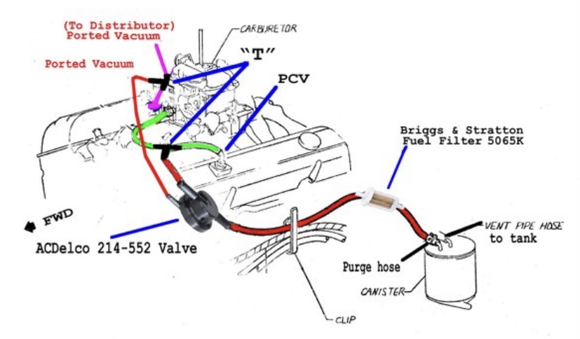

Alan
Supposedly, with emissions no longer present, this is how it should be hooked up (picture below). Not so sure about the additional filter. I didn’t use one. But I did use a vacuum gauge and it pulled enough to remove the fumes. It worked for my need and my truck doesn’t smell like raw gas since changing out the canister.
