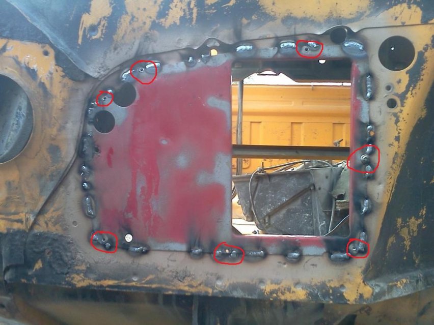

I done the opposite on my crew cab converted from non ac to ac

it would be easier to cut your firewall out of the non ac truck and fit it like I did on my crew cab
I have a couple pics and a short description on how I done it in my crew build thread click the link at the bottom of my posts page 8
