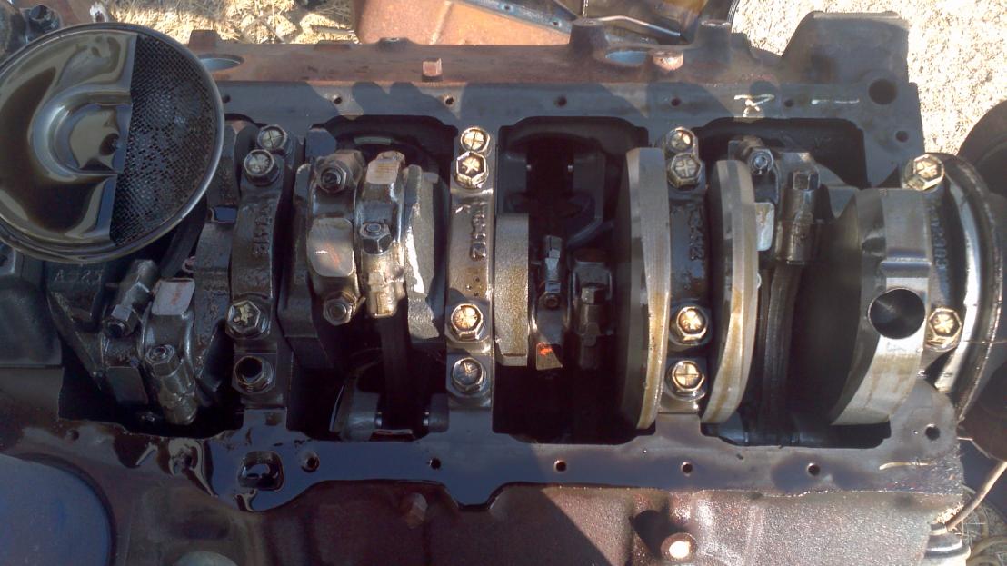

lol working on the motor, well i got her all the way down to the block, going to take the block to work and do a little honing on it on monday. i think everything looks pretty good, as in crank, timing chain, timing gear. think im gonna price some new pistons. but for now im just glad its all apart so i can start getting ready to get it back together.
