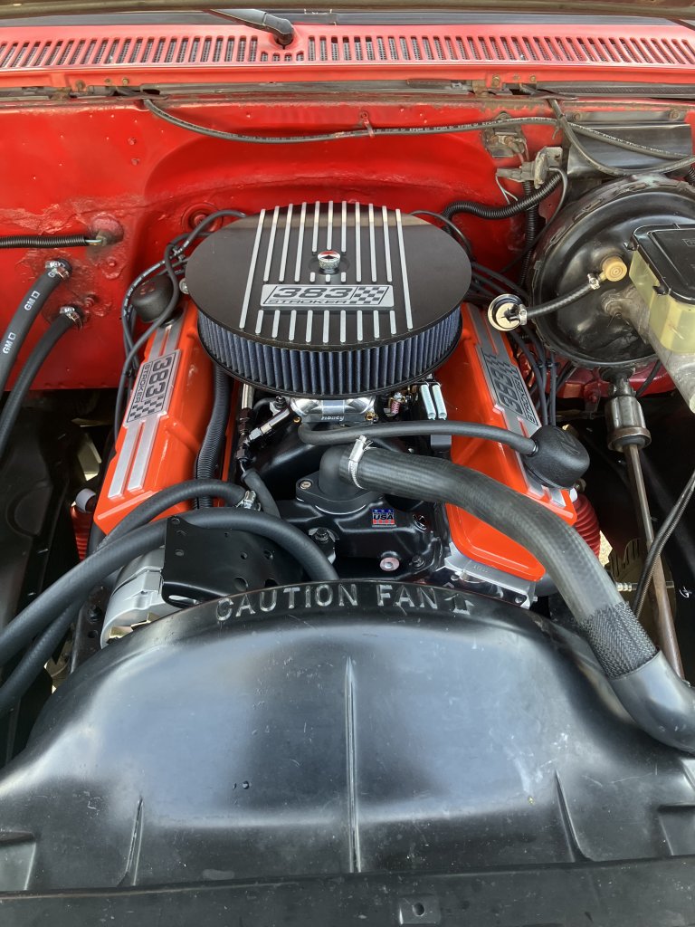

76cc chamber with small valves. There's one thing you could improve on without a full rebuild, small chamber heads with the bigger valves however at that point id do a cam and lifter set as well while I was in there.
Also yes if the blocks ever been decked it'll wipe those numbers behind the alternator out they are stamped with a punch, they may still be there if your lucky.

Looked, used steel wool, used very fine sand paper. No luck. The pad is not perfectly smooth, it looks like it has been machined. No numbers.

So where does that leave it? Do I bore scope the cylinders looking for "flat pistons"? What info do we know about the heads and block? In layman's terms.

As for the block the pistons could be anything, a scope could allow you to see if they are flat or dished. The heads are basically crap as far as performance is concerned

I could bore scope through the oil pan drain plug to see the main caps?
But as far as minor performance upgrades are concerned, I suppose it doesn't really matter if its 2 or 4 bolt.

A cam and a better set of heads, even just stock type heads with 64cc chambers would be an improvement over the ones currently on it. Possibly even a full rebuild with a set of flat tops.
