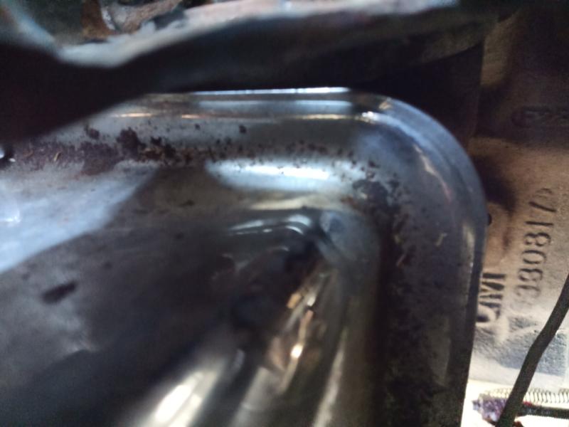

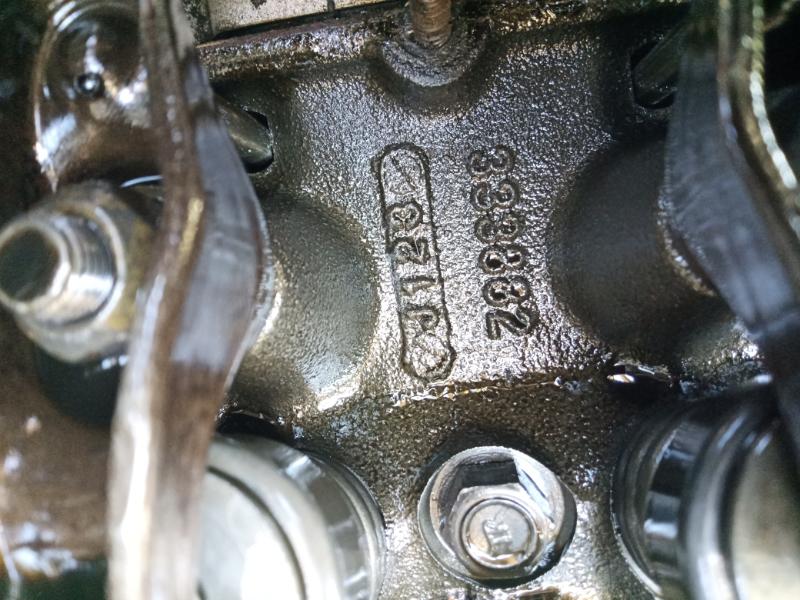

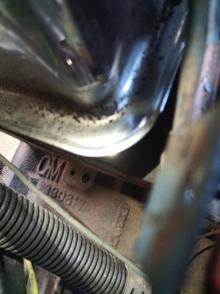

Casting number for block should be behind the driver side head on the top of the flange were the trans bolts up. The head numbers are on the top of the heads under the valve cover between the rockers.
Here are the numbers one for heads one for blocks

The valve covers are easy enough to remove. They are chrome with those hand twist of things. No tools required. If I got the block number and a head number, would you be willing to decipher the hieroglyphs for me? It would be kinda nice to know what it all is.

Numbas

882 low compression smog heads. I don't use block numbers not enough info from a block number all that tells me is it's a 400 block. The number behind the alternator tells year,compression,2bbl,4bbl,auto, manual,hp
