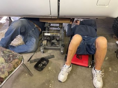

Hi! All bed bolts were like new condition so i guess i got lucky. I was able to move the bed back enough to work on the sender units, new fuel lines. Thank you for your help!
