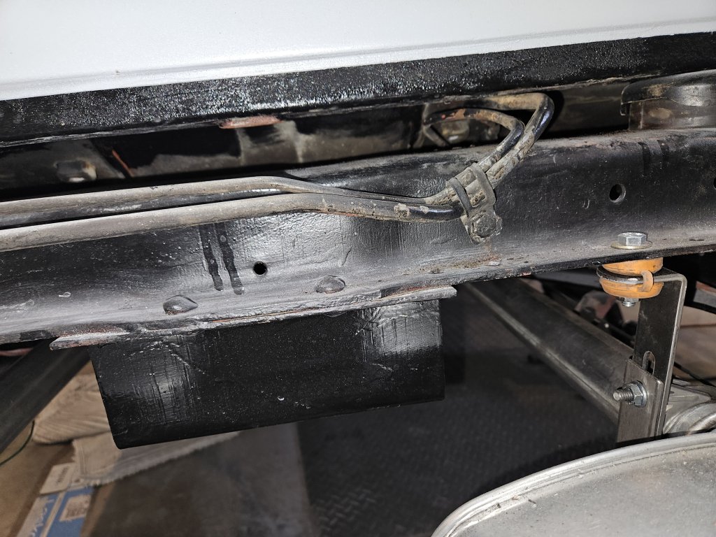

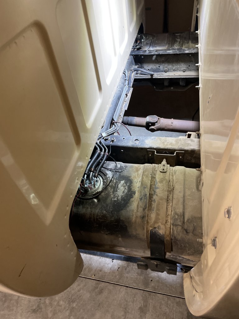

Here are some pics (1982 C20) of what things look like if you decide to dop the tank.

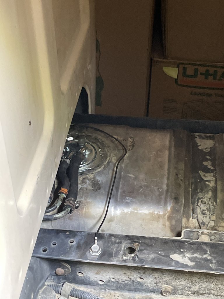

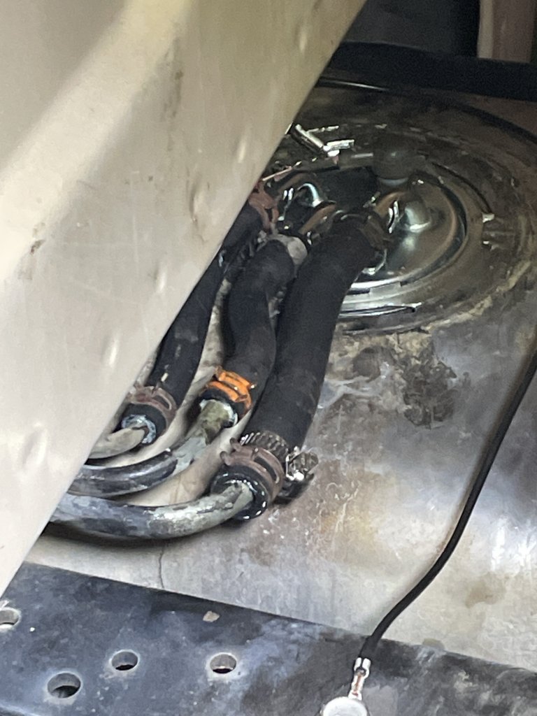

The bed removal has been completed. Now to fix my fuel gauge issue.

I was able to move the bed back about a foot. Gave me room to get in there and replace tge senders and hose’s. Thank you!

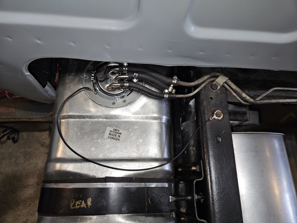

I just replaced the tank along with the soft and hard lines on my 1985 K20. Single tank, driver's side. I started by dropping the tank which pulled off the rubber hoses between the tank and the hard lines. These were only about 6 inches long so the tank is not coming down without something bending or pulling off. However that is not the problem....getting new lines in and secure and getting the tank back up installed. Ultimately I ended up removing the bed....engine lift and a jig from Summit...actually a one-man job that way.
If you are going to replace your hard lines please let me know. I had a confusing time trying to order the right ones. I should be able to point you in the right direction.
Hi! My lines were in great condition so i cant help you there. Sorry

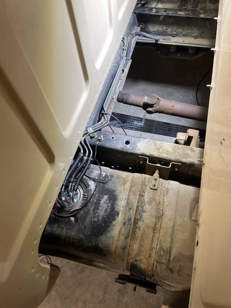

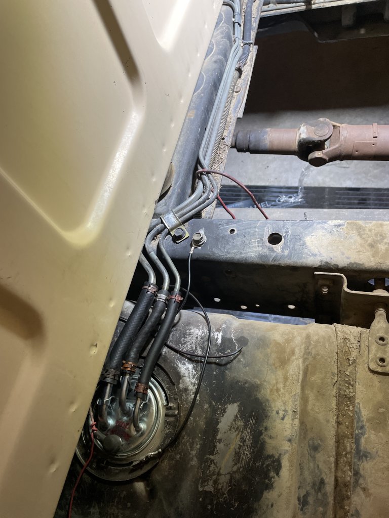

You NEED 2 people or a welder to remove bed bolts unless you just cut em off or split the nuts. They are 100% guaranteed to spin unless someone is standing on the bolt head or you tack them to the bed floor.
Even if they are not corroded, they’re about 20% guaranteed to spin.
Just a heads up.
Hi! All bed bolts were like new condition so i guess i got lucky. I was able to move the bed back enough to work on the sender units, new fuel lines. Thank you for your help!
