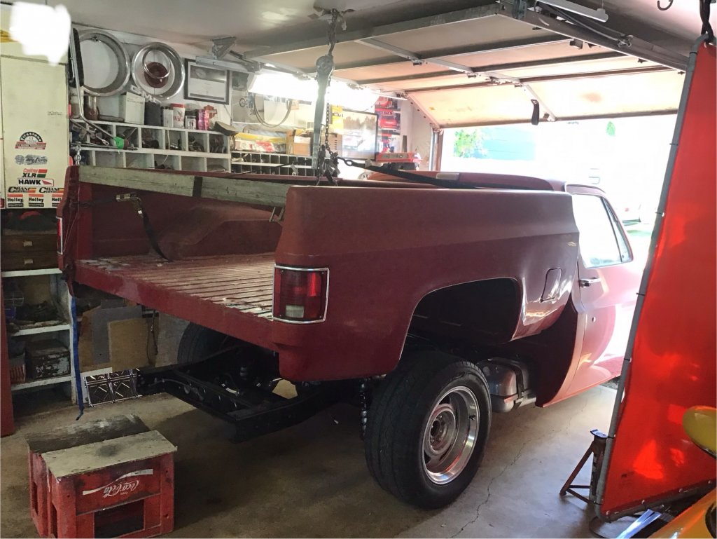

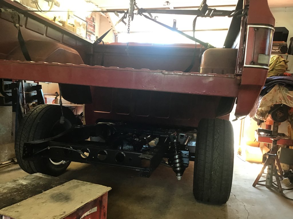

I lifted the box by putting a 4”x4” post between the joists of the garage and wrapped a chain round it. Hooked a come along to Strapes on four corners and a 2x4 across the back so sides don’t pull in. Did this as a one man dance. Worked good.
