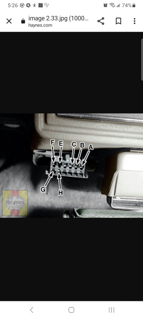

Your 1987 does have a way to read the codes in the ECM. A decent shop should be able to do this, you can do it at home if you need to. Hopefully someone will come along that can tell you the procedure but it involves jumping across two pins on the diagnostic port. That is located in the same place as most other modern vehicles, basically underneath the brake release lever. Then you count the flashes of the check engine light.
No point in guessing when you can definitely read the codes.
This pic just shows the diagnostic port on the bottom right in the dark part of the pic.

Short terminals A and B together with a piece of wire. Your check engine light is going to flash codes similiar to Morse code you're going to get a a long solid light a pause and 2 quick blinks that's a code 12 it should repeat 3 times then move to the next code. Be ready have paper and pencil. Get me the codes let's see what we cam figure out. Also if you're not having a drivability problem don't get in a panic the check engine light should be a watch the converter light because that's what iylts primary function is,to protect the converter or evap emissions,not your engine,transmission or anything else. Drain your oil and go for a full throttle blast down the highway,your check engine light will not come on. Unplug the oxygen sensor it will come on.
after you jumper A and B, turn the key to "on". then the light will flash codes. otherwise solid advice.
I'd also check the no start chart in the service manual
