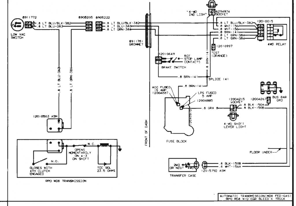

This was my understanding also- I also don't have an EGR (wires are just tied up out of the way.) The wiring diagram you posted is how my K10 is.

Just posting this if someone is curious. This is the wiring diagram (like the original posted in post #3-without EGR bleed.)

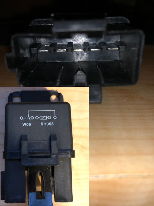

4wd have the unobtainium 4wd relay setup that disables lockup when in 4wd
I meant to mention this earlier- I found a relay that will work - Relay RY31 around $20 at Oreilly or other part stores
