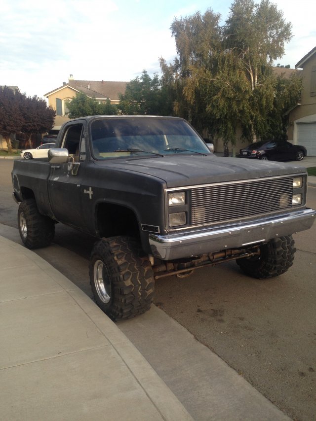

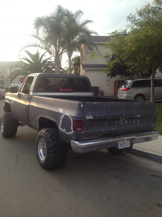

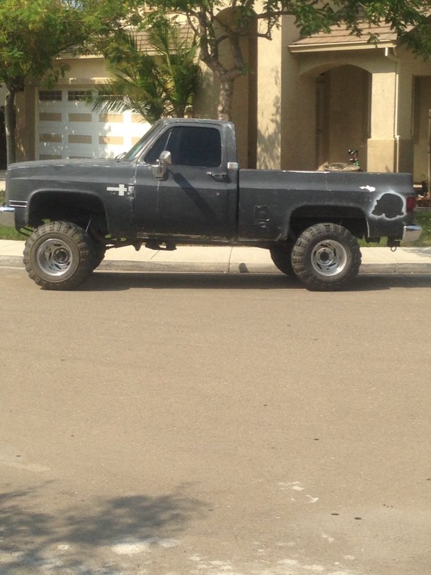

What would cause this to happen. Looking on the left hand side of the truck the body line doesnt line up and the bed gap is bigger on the bottom then the top. From behind you can see the cab leans to the left more. And on the right side the body line matches but again the bed gap is bigger on the bottom. I checked the body mount bushing and they are pretty bad. Would replacing these fix everything? Need some help please.

It sure wouldn't hurt. Mine has the same problem. Sharp truck.

Thank you. Im hoping my frame isnt bent. I dont like the banana look. And do you know if there is a huge difference between soft and hard body bushings?
