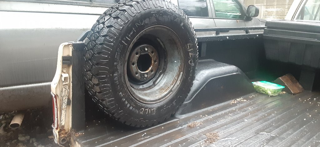

Got it finished up this morning despite having to work in the rain. I'm not allergic to rain, if I was I'd never go outside here lol. So as I was walking out to truck I was thinking about what @Grit dog was saying last night. Up until now I was pretty set on putting bolts in the bottom bracket, but decided to go with the self tappers because they'd make a much smaller hole in the bottom of the bed, and if I get rid of the bracket at some time in the future it would be easer to fill the hole with a quick spot of weld and grind it flush like it was never there. I am a little concerned about strength with the self tappers, but if it's a problem I can always move to bolts in the future. Ok picture time!
Below: The mount installed, as mentioned before the only reason the top bracket is so long is so I could mount it using existing bolt holes. It would be perfectly fine to make it as small as the lower bracket.

Mounting the spare to the bracket is as simple as two long bolts. I used what I had on hand. If your using the same material I am the problem would be that in order to have a bolt that will take a washer big enough for the bolt holes in the wheel, that bolt will be to big for the existing holes in the bracket. I wanted to keep this simple, and I had long enough bolts that were small enough to fit the bracket holes. So I cut some scrap material to use like washers and put the nuts on the inside. I used what I had on hand and this works for now. Moving forward I might replace the bolts with J bolts. Take a look.
I have it set so it's tight against the inner fender, but has a couple inches between it and the tailgate.
