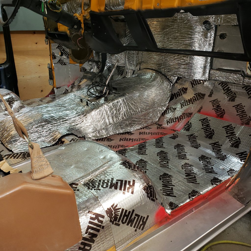

Kill Matt is pretty cheap when it goes on sale. I did my floor and firewall. I also got to noico 10 mm stuff and did two layers on firewall and one on transmission hump for 200 bucks canadian.
And I will say once that stuff is on there good luck getting it off. I left a pretty big piece out so I could fix up my floor. Hence my red on hand spray paint over spray on what I had down before repairs
