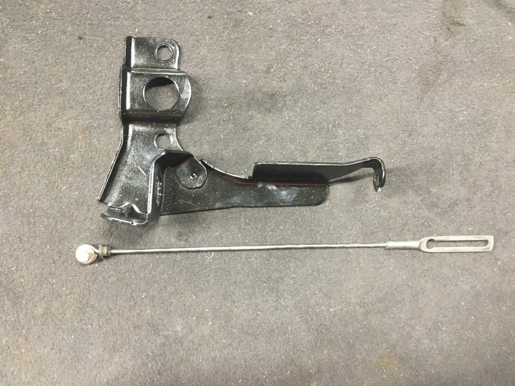

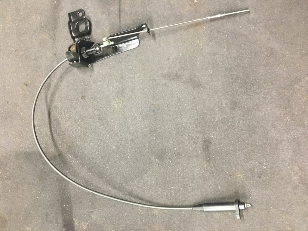

There are a few TV cable / brackets currently on EBay for the 6.2L . The TV bracket and the rod that goes with it is basically unobtanium. When you can find them expect to pay dearly for them. The Cable is discontinued from GM there and there are 2 after market cables available , one from ATP part number Y-225 and one from Pioneer part number CA1933, the ATP one is an improved cable built the same way as the OEM one but with a heavier cable. The Cable it's self is longer in the ATP one but the ratio is correct. Not sure about the Pioneer one.
