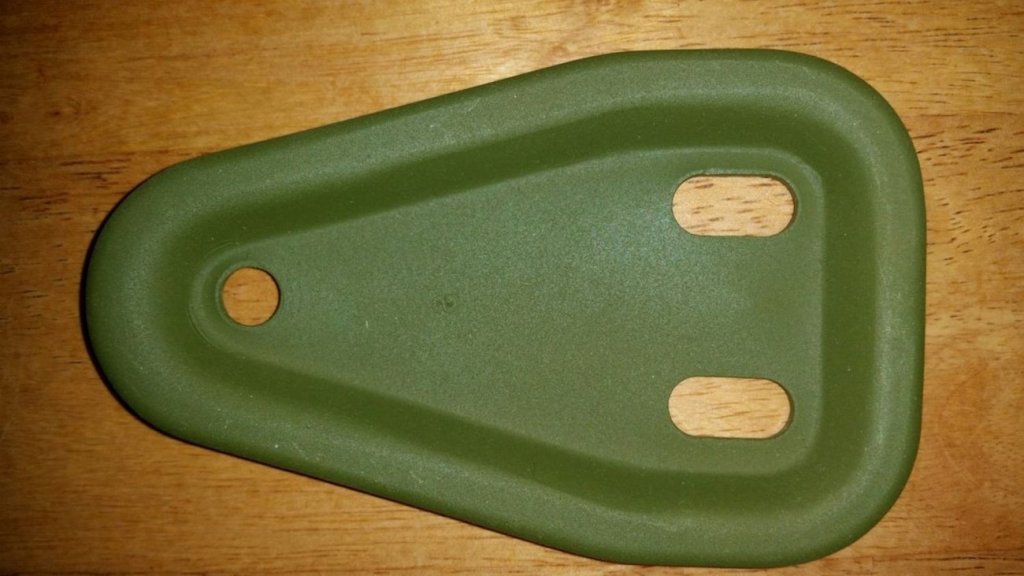

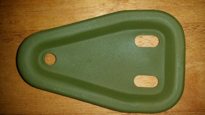

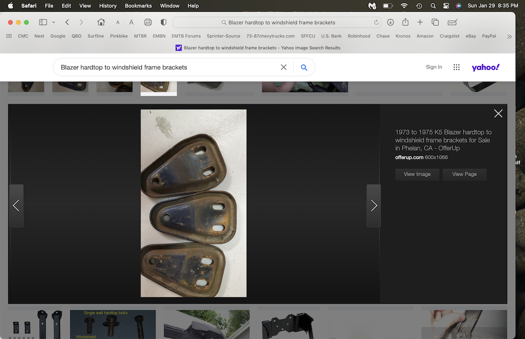

Hi,
I have been looking for quite a while and unable to locate windshield to hardtop brackets for a 1973 K5 Blazer. If anyone has a set or knows where I can find them? It would be much appreciated.

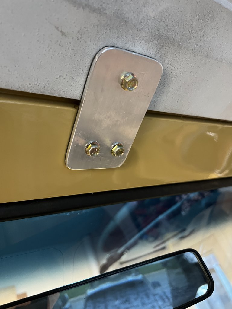

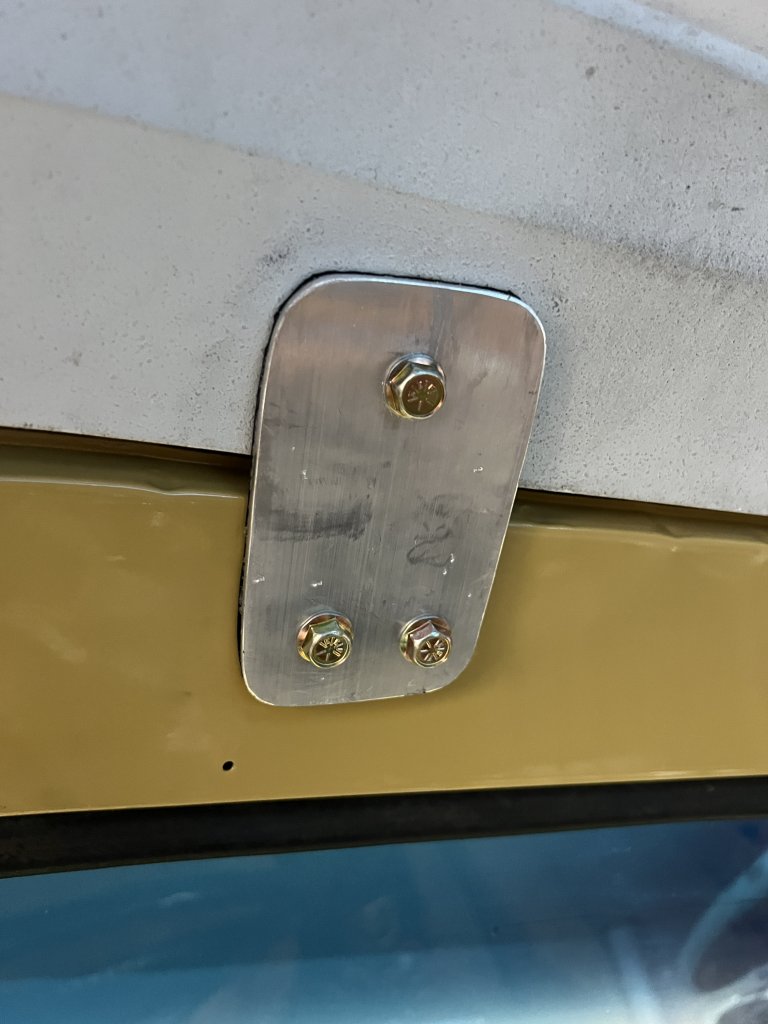

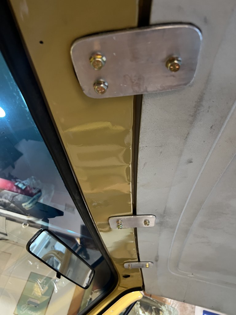

Decided to make my owner brackets out of 5" x 3" x 3/16 aluminum stock. Then glued 1/16 rubber sheeting to the inside of the bracket to protect the paint on the windshield side of the vehicle. Came out nice and the stock was relatively cheap, less than $20.
