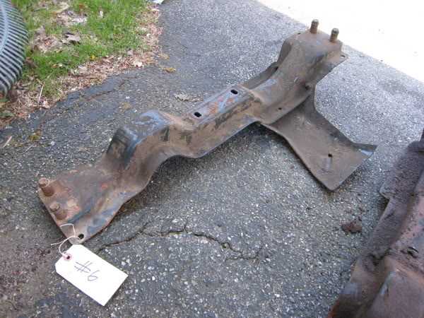

first thing is your nv4500 from a dodge or a chevy.
I don't know what it takes to put a 205 on a dodge nv4500 but I know you can build a dodge/chevy hybrid nv4500. dodge front input shaft and chevy rear output.
the cross member you need is from 85 up chevy I am pretty sure they used the same cross member for all trannies in squares after 85. on a1 ton you will need to put the cross member inside the frame and space the tranny up a 1/2'' to make up the difference in the frames 2'' total
look at my nv4500 thread for details on how I done mine
for a chevy nv4500
it has a 32 spline output shaft
you will need a turbo 400 205 32 spline short input and it will fit the nv4500 after cutting for clearance for the shift rail.
or you can use a 32 spline 205 long input gear and the adapter from advance adapters. but you still need to clearance the nv4500 for the shift rail.

do you know part numbers ? to crossreferance exact models so im not looking for a needle in a hay stack
kleedus
Jan 25, 2012
1,726
164
wyo
Ray
1960 threw 91
c10 to k30
350 threw 454

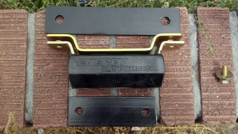

no 89 k2500 is the wrong body style
I have a couple I would sell you 1 for 40 bucks plus shipping
and as for your question on spacing the mount if you look at the pic I posted of the energy suspension mount it shows my 1/4'' spacers 1 on top and 1 on bottom to get a 1/2''
the 1 ton frame is 2'' taller than a half ton. moving the cross member makes up 1.5'' and the spacers make up the other 1/2''.
I don't know if a dodge tranny uses the same mount or not that's something you will need to figure out
