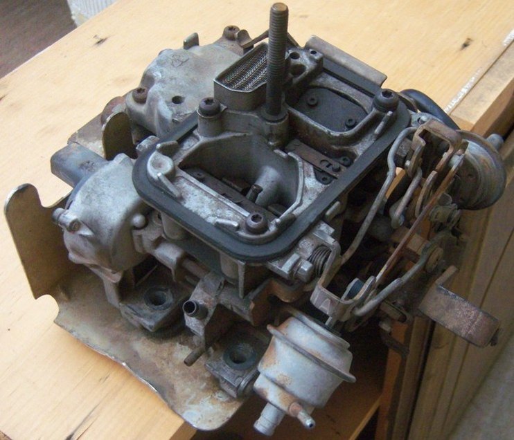

Does your carb look like this? These are some real picky bitches.

my carb kinda looks like the one pictured but a litt different mine is a vari jet 2 cleaned the carb with cleaner 3 times made shure all the holes were clean that i could find if you pump the acellerator it will keep running or floor it it will run wide open got the idle agj adj rite my carb only has one idle adj screw on the side of the carb was one of those sealed ones pur chased a new dist. waieing for it to come ups thanks for input guys ive been working on chevy csrs and trucks all my life this one has me stumped

iv the dist doesnt fix it gonna take carb back off and clean it again never used the wire chaser thanks
