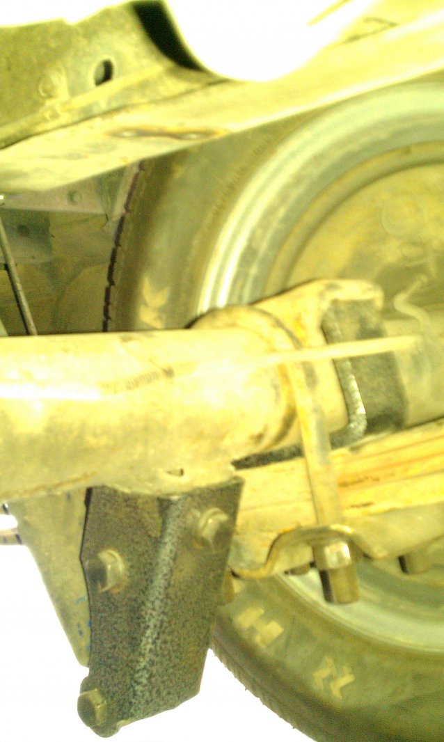

OK, in the front you have the stock spindles, probably cut stock coils, and the bump stop brackets cut off the lower control arms. You also have those cheezy coil spring lift blocks.
In the rear you have 56in leaf springs that would normally have about 7 or 8 leafs total so it appears the PO removed a few. The rear bump stops have also been somewhat removed off the frame.

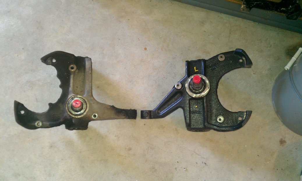

If you want it done right on the cheap, you can buy lowering parts individually instead of a complete kit.
The very basics that you need for a 4.5/5in drop you need a 2.5in drop spindle, one round cut off the stock coil springs, a flip bracket, and shock extenders.
I lowered these two truck with only these parts.
