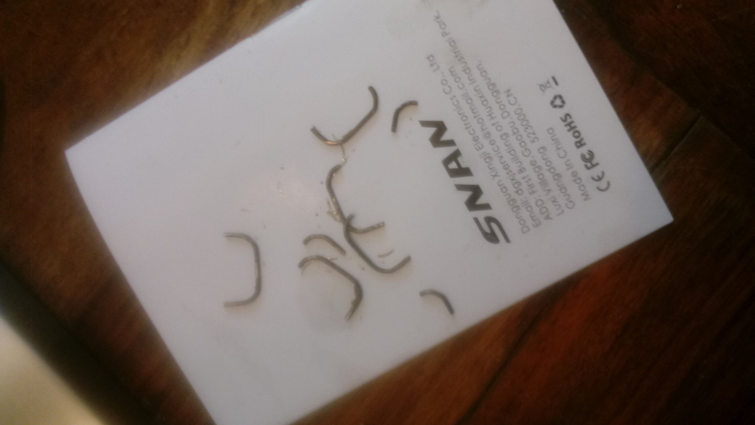

Hey guys i dropped my oil pan today to replace the gasket and found these at the bottom. Any idea what they are from?
47,210
9,483
hmmm, I'm wanting to say they look like lifter plunger retainers. A pic with a penny or something for a size comparison might help.

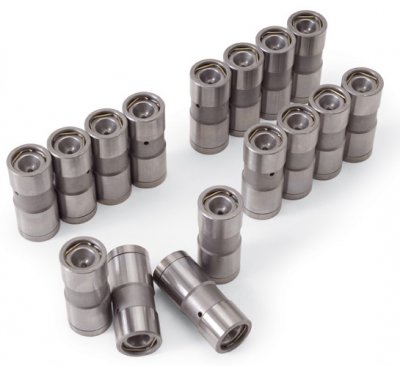

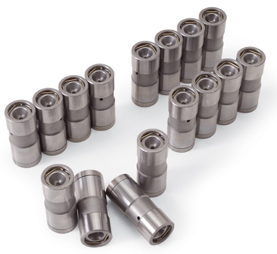

See the wire spring clip retainers in the top of the lifter that holds the plunger in place?
So long as your rocker arms don't get loose and the pushrod keeps tension on the lifter plunger, you should be OK, but be prepared, when you do pull your rocker arms and push rods, those lifters are going to be coming apart and spitting their plungers and plunger sping out of the lifter bore.

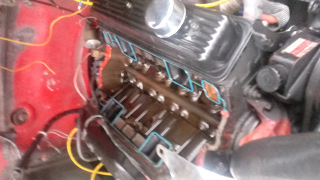

Pulling it apart now. So the lifters will spring off in a way? What should i be prepared for.
47,210
9,483
It's not high spring tension, just that as you pull the pushrod out, the plunger is likely to follow. Just do one and ease the plunger up with the pushrod and then you'd have an idea of what you're dealing with.

Indeed it was my lifters, I've pulled the intake and inspected them. I found atlas 3 failed lifters so its time to buy new ones again. Im not sure what caused the failure. Could it be over tightening the rockers?
47,210
9,483
I'm not really sure. Maybe a defective batch or brand of lifters? Very high rpms and floating valves and push rods bouncing on the lifters maybe? :shrug: What type of rpm do you turn? Do you do it very often and to the point you float the valves? Maybe your cam is big enough you need double springs?
47,210
9,483
The good thing is, so long as the valves were adjusted properly or a hair to tight, that kept the lifter plungers in the lifter bores so no harm was done to the engine whatsoever. New set of lifters and you're good as new again.
