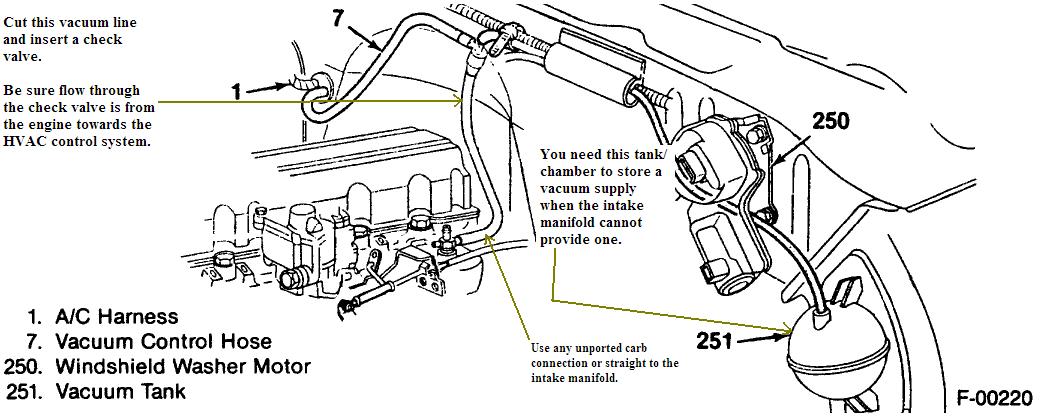

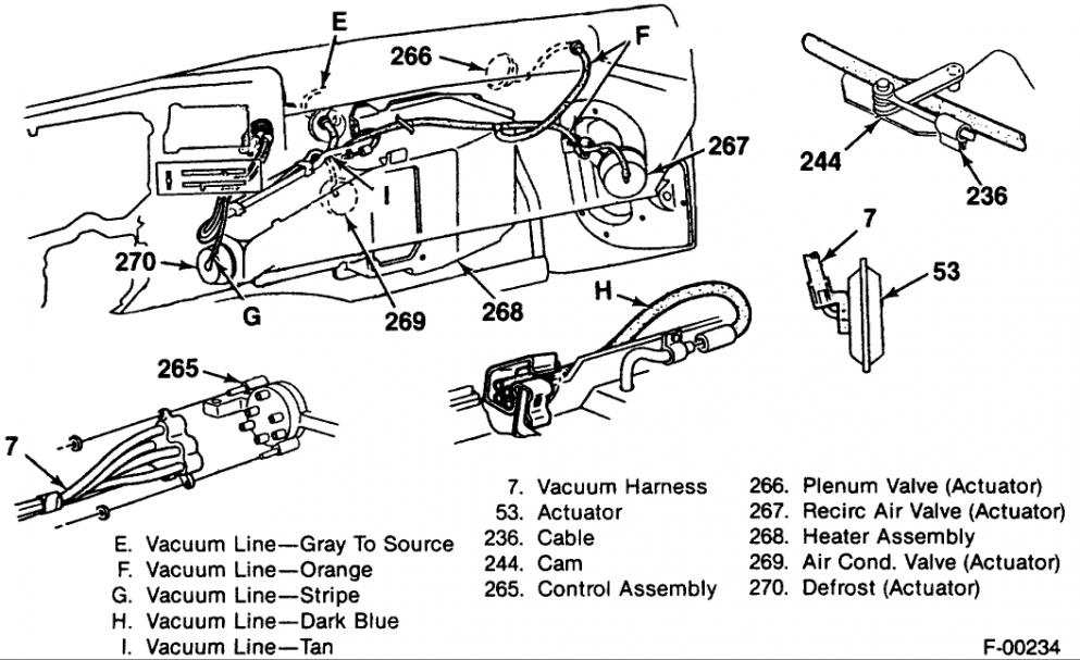

These images my help.
Do you have a vacuum chamber? It isn't absolutely necessary but helps smooth out the controls during times of varying engine loads.
For a vacuum supply, I tee into the transmission modulator line in the back of the intake manifold. Be sure and install a check valve where indicated. Also included the tubing schematic for dash side:
