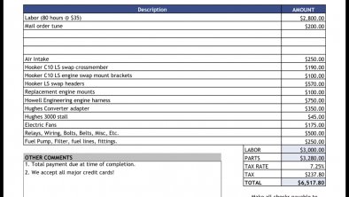

Does this not seem a bit too high? Not including price of the motor and computer. Most of their prices seem high but are name branded stuff so I can see it being near this much for all brand new stuff! I certainly think most of this can be bought cheaper or even slightly used.

Doesn't surprise me considering half that is the labor costs of a shop.

good price
a bud here charges $10,000 including engine at $50/hr
oops: including engine, harness, etc

for all the work and new parts I guess it's not that pricey, I'm sure there is other little stuff I'm sure that'll pop up, I can get a motor and computer and stock harness for $600, hard to believe a harness new is $750/$800 dollars though.
$750 for a custom fit harness is about right. I just paid $700 for one with factory sryle wiring spliced in and plug in bulkhead connector simply because I am running out of time on mdifying another one my self. Over all prices look to be reasonable for exception of motor mounts.
