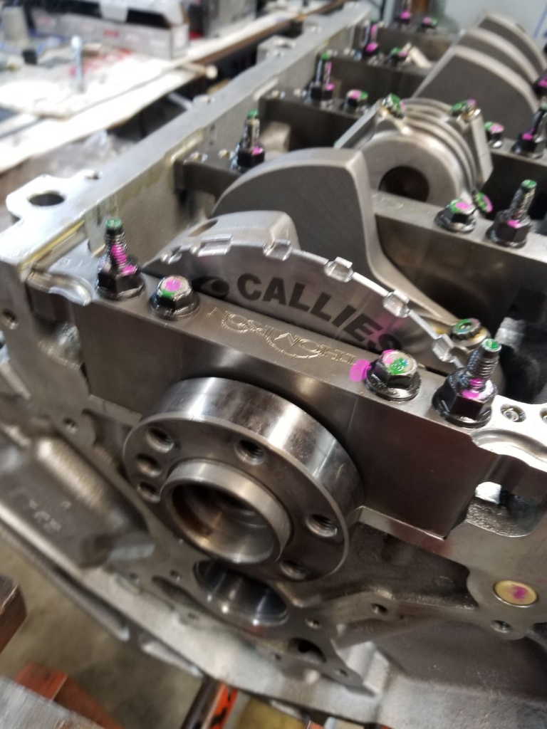

Me to! But I'd be investigating it my self. These motors are to easy to work on.
right, but I took someone to a yard that i half trust. He said " if it's not a 5.3 are you going to feel the difference? I mean, they have the same lower end as the other". No they don't. Lesson learned again from this yard, it was a 4.8. So now he's had to get a 5.3 crank and connecting rods.
