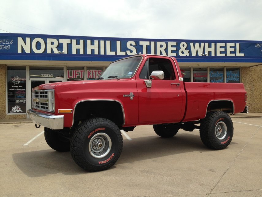

Hey guys! Looking for some help here. Just bought a complete LQ9 and I'm looking to use the a/c compressor in the factory lower passenger location. Does anyone have any recommendations on how this can be done in the best and easiest fashion? Also does anyone recommend a long tube ceramic coated long tube header that offers O2 sensor bungs already welded in?
Application in SWB 1986 K10 with 6" lift
