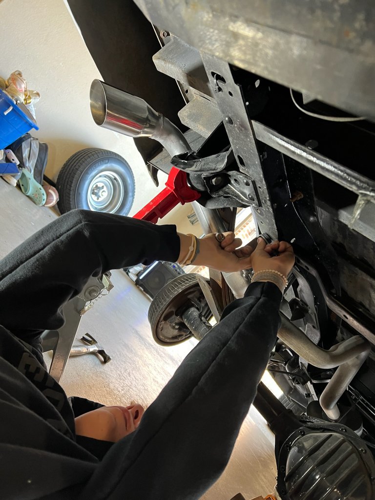

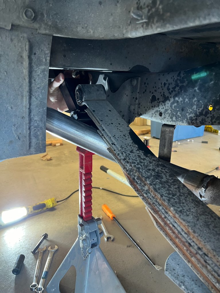

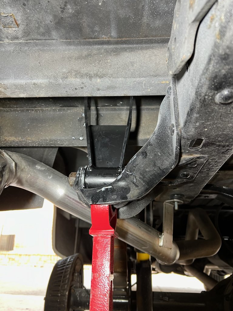

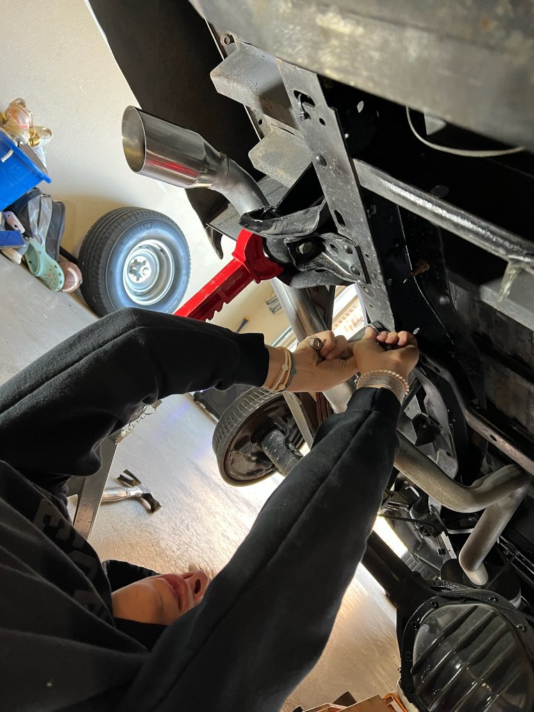

We did like @FireTruck1984 did. 2” drop shackles from Summit Racing. About 30 minutes and done. Nice and level.
Randy and E
