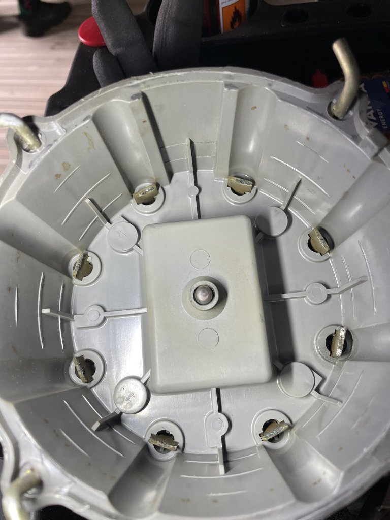

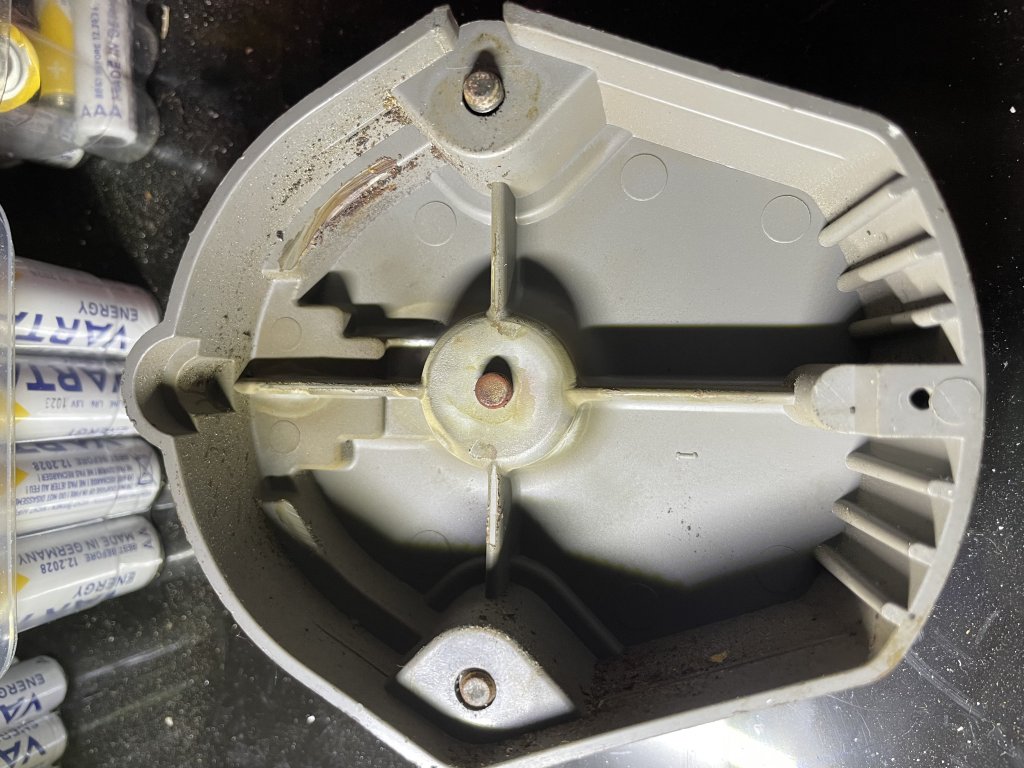

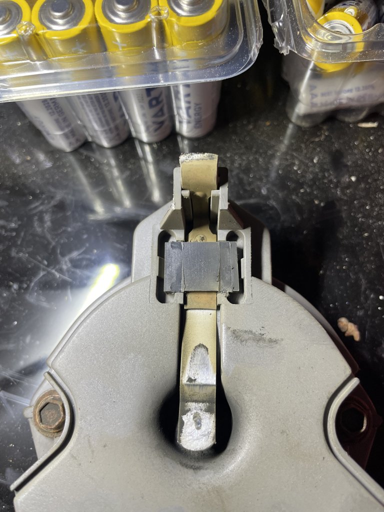

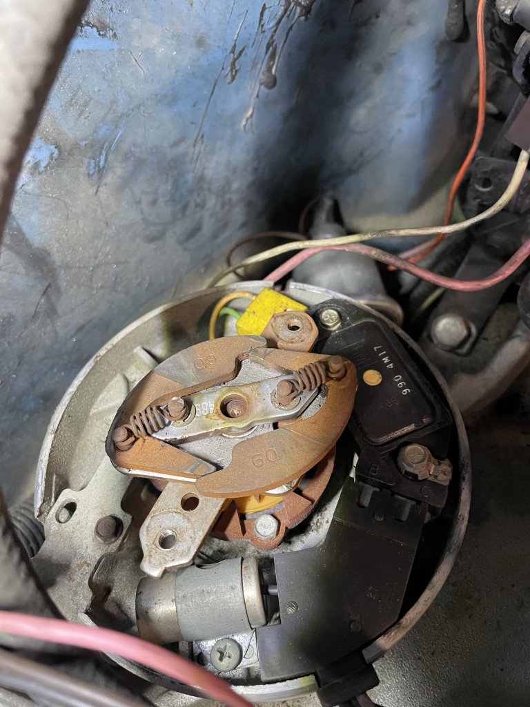

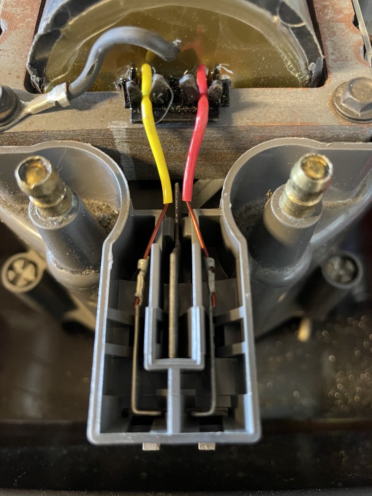

Pulled the distributor cap and pulled out the rotor also. Coil measured OK according to the Haynes manual.
Did not seem to bad in there.

The distributor cap and rotor have seen better days.

Is vacuum advance pod still working?

Not sure… How can I verify this?
Im not the best at explaining. Vacuum pod is on distributor. With cap loose and hose off of carb you can suck on the hose and pull Vacuum to see if pod pulls advance plate or not. If it moves and holds its good. If it tries to move then springs back it's leaking. Hope that makes sense
You mean the cap needs to be loose or off?
Only so you can watch it move. I never need to watch to test a pod, I just suggested it because I don't know what you know. It's just easier with cap off so you can watch it. Also I've had a working pod but the weights were frozen and not advancing. That I would not have seen with cap on still.
Tried sucking on the hose, but did not see any movement. Should it be enough just with normal human lung capacity? As the issue seem to get worse the hotter the car gets and with load on the engine this could make sense.
Edit: connected a pump to to vacuum advance, and its verified OK.
I’ve ordered new rotor and cap with coil as they was looking not to good anyways.
