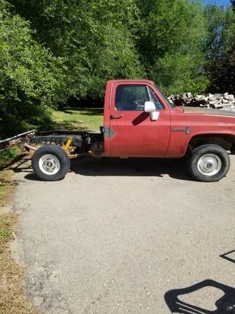

So, got a chance to look at what I'm calling Lil Red last night. I want to buy it. My wife not so much. Especially if I get it for $2500 or less.
He needed to pour fuel directly into the carb, but once it was running, it ran just fine. I didn't feel anything weird in the trans, put it in 4LO and it still went just fine. Didn't screw with the locking hubs.
The front inner fender is rusting out, apart from that everything is surface.
Some leaks, namely I noticed from the engine oil dipstick tube, which I imagine is an easy kill with a new grommet/o-ring.
Only has a heater, but the fan does kick on.
Current tires are old but lots of life on them.
Headlights/turn signals need new bulbs or work.
Rear lights work great even though the housings are bolted straight to the bumper.
The stereo that was in it had power at least, but I didn't try turning it on.
Seat has two massive rips and it looks like dried oil or paint. It's worthy of a refresh, maybe I'll replace with a 40/20/40 or 60/40.
He's asking $2900 obo.
Now for the questions for the group:
What axles and gear ratios can I expect in this thing?
The 250(definitely a 250)/3 spd auto, anyone have an idea about mpg?
Anyone made a wood bed for a short box?
How bad is a front passenger side fender?
Where do YOU all find parts at, besides craigslist/FB finds? I know about LMC, but where else is consistent?

FireTruck is more than likely correct - but - to answer your specific technical questions:
Axles: Corporate 10 bolt rear, with 3.42 standard or an optional 3.73 ratio
MPG: I would expect low 20's/high teens highway
Wood bed: yep - they are all over the place. Probably some running around in your town as we speak. Or - find a different box and set it on
Fender replace: neither the fender outer nor the wheel liner is a difficult replacement. Fender outer is three big bolts at the rear with 7 or so small bolts at the front. Inner is about a dozen small bolts around the wheel opening and one big bolt into the front of dash.
