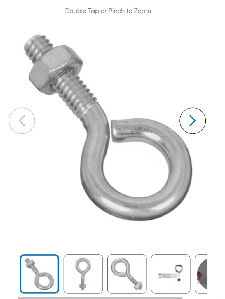

Start with a cheap instant on alarm no stickers no warning lights,leave the truck unlocked,crooks think you're an easy mark,when they open the door SURPRISE!!!! This way your window doesn't get broken or your column smashed. Do your hidden kill switch. Bolt an eyebolt to the radiator support and a piece of chain to the bottom of the hood. Padlock the chain to the eyebolt.. No one is going to stand there with bolt cutters cutting your chain while a siren is blaring. If they really want your truck they'll just pick it up with a wheel lift. Again the alarm goes off.
