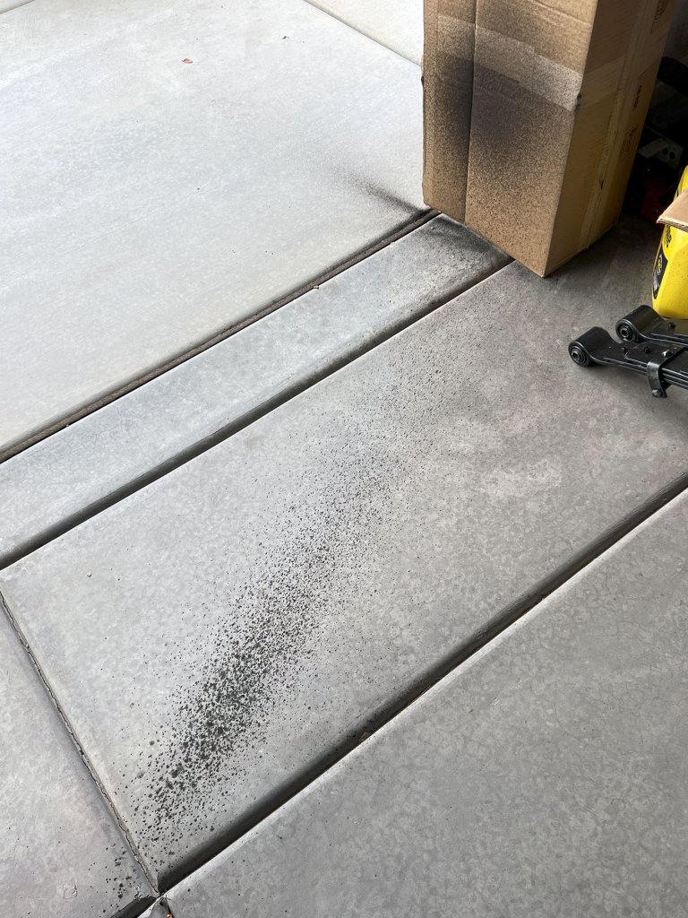

Getting a ‘73 K20 running that had been parked since 2005. I rebuilt the carb, replaced the plugs and ignition wires, checked the points and condenser, and have the timing set for 4 BTDC. I also changed the oil, drained the old fuel, and ran fresh gas through the pump to push out any old gas before reconnecting the fuel line. The truck starts fairly easily and runs okay. It emits a bit of whitish smoke and the tail pipe splatters oily carbon spots all over the garage floor when I pop the throttle. Out on the road, the truck seems okay until I run up the RPMs fairly high or put a load on the engine. At which point the engine backfires.

Quick update. All the valves are functioning fine. I turned each of the rods, and all turned fine, so they should be straight. No excess slop around the rockers. I also put the timing light back on and checked the advance when I blipped the throttle. The timing mark advanced as the RPMs increased. I'm off to NAPA to get a vacuum gauge and fresh set of throttle return springs. When I got the truck, it had no spring on the throttle return. I don't know if had rusted and fell off or my Dad was doing something and forgot to put it back on. I put on a spring I had laying around, but it isn't strong enough. I checked the exhaust again, and it is still very dirty. See attached pic.
Looks to me like normal cold condensation in the pipes. That means you have a leak-free exhaust system.
Yeah old engine, no cats to trap stuff. The 86 spits black chit out just like that. And it runs just fine.
Again no cats, the old 86 is a smoke (steam) show when the weather is cool. Until the engine warms up.
