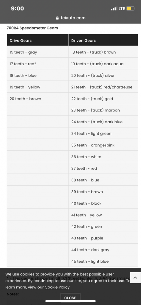

On my '84 K10 that I just bought, I am having the 700R4 rebuilt and I have a question for you guru's. The Truck is running the original 203 transfer case with a stock 3.08 ratio rear BUT, the PO lifted it and added 35 x 12.50 R20 tires and wheels. I assume this makes the speedometer read incorrectly. I understand the speedometer is actually driven from the transfer case and not the transmission so do I change something in the transfer case and not in the transmission as I have done in 2wd vehicles? If so what do I change and where do I get the parts? Your advice is greatly appreciated!

There’s a Speedo gear in the transfer case that needs to be changed. The speedo gear is what your speedometer cable plugs into in your 203 transfer case. To figure out what Speedo gear you need, first you must see what drive gear you have on your 203 output shaft. You can then use (the drive gear teeth amount, your rear diff ratio, and your tire height) to figure out the Speedo gear needed to make an accurate speedometer.
Plug in your numbers here and use this calculator page to figure that out.

Thanks Joshua! I have the 203 transfer case and not a 208 Does that make a difference? Sorry, I read your comments on my phone and misread the number. I see now that it is related to the 203. Your advice is greatly appreciated Where should I go to purchase the proper gears?
MY BAD, IT IS A 208 C !

I believe this works for the 203 and 208. I believe my 208 had the gray 15 gear so used that in my calculation. You may have to take off the tail housing to see what gear you have. Oh it doesn’t matter. eBay, Amazon…they’re pretty inexpensive.

Also one more thing. On my 208 there were multiple different Speedo gear housings. One for teeth with a range of like 20-25, 26-30, 31-35 and so on. You must have the correct housing for the correct gear.
