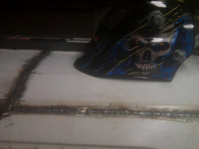

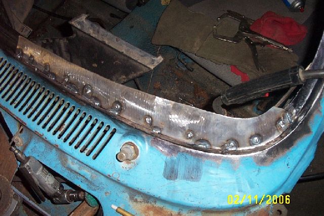

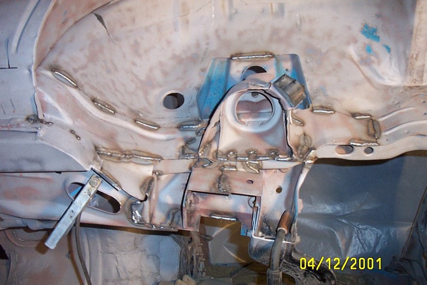

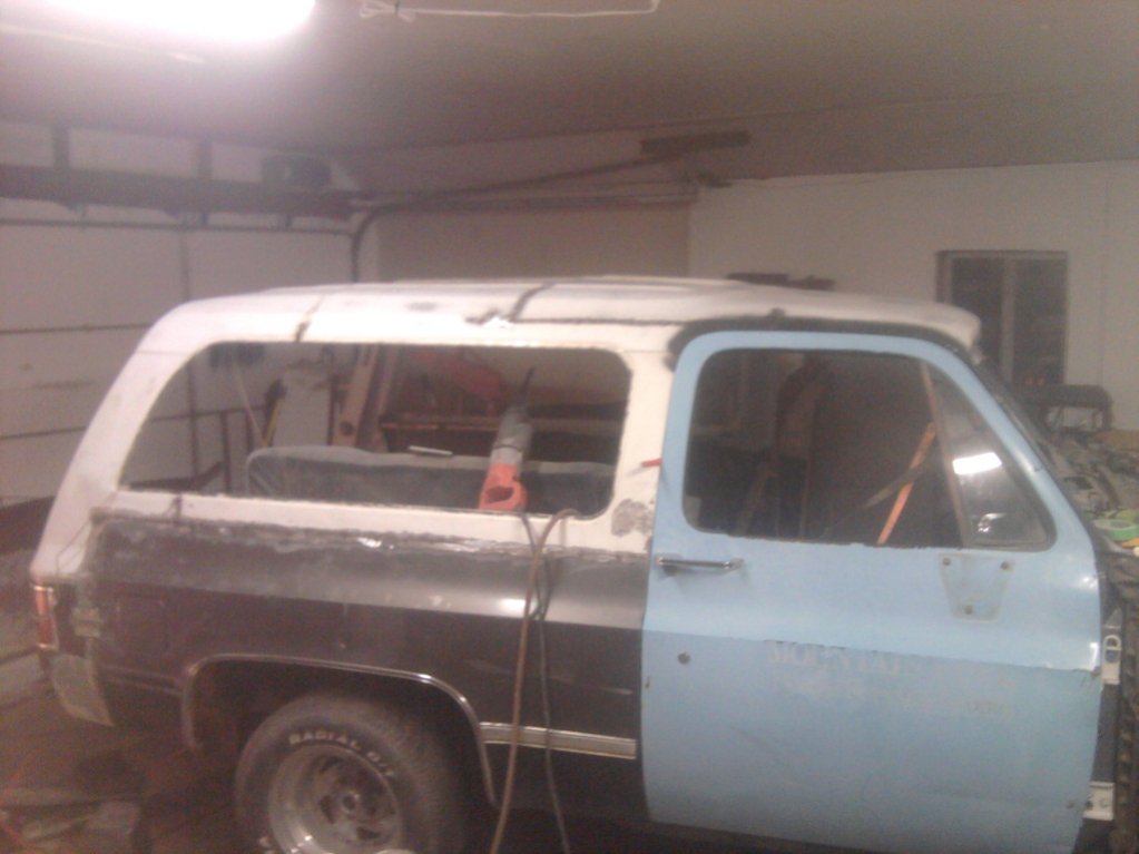

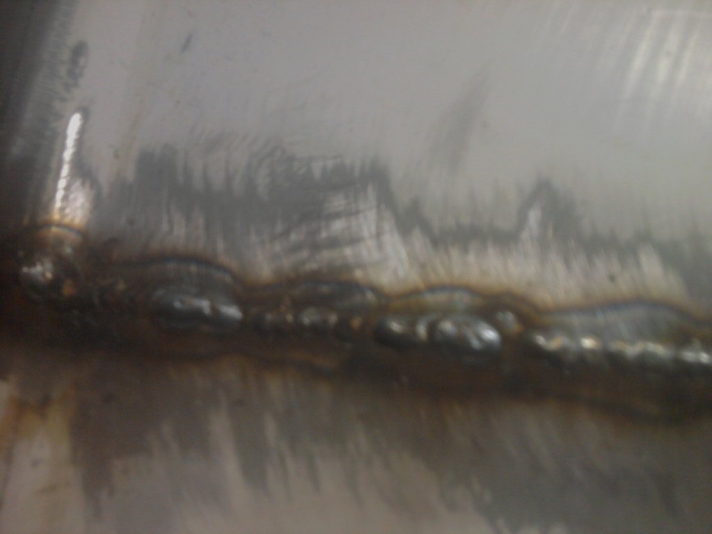

do not use flux core on sheet metal you will regret it if you do
I have done a lot of sheet metal welding I am a self taught welder
move your welds around the panel to minimize the heat do short welds
and be careful grinding the welds down that makes a lot of heat as well
buy a good welder it will make your life a lot easier in the long run
I tried to weld a patch in a door with a cheapo flux core welder I ended up getting pissed smashed the welder with a sledge hammer. then went and bought a Lincoln 135. its not the most expensive welder but it has served me very well for years and many projects.
oh ya get a auto darkening hood as well I bought mine for 150 bucks well worth it
