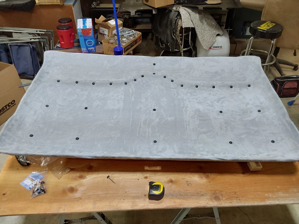

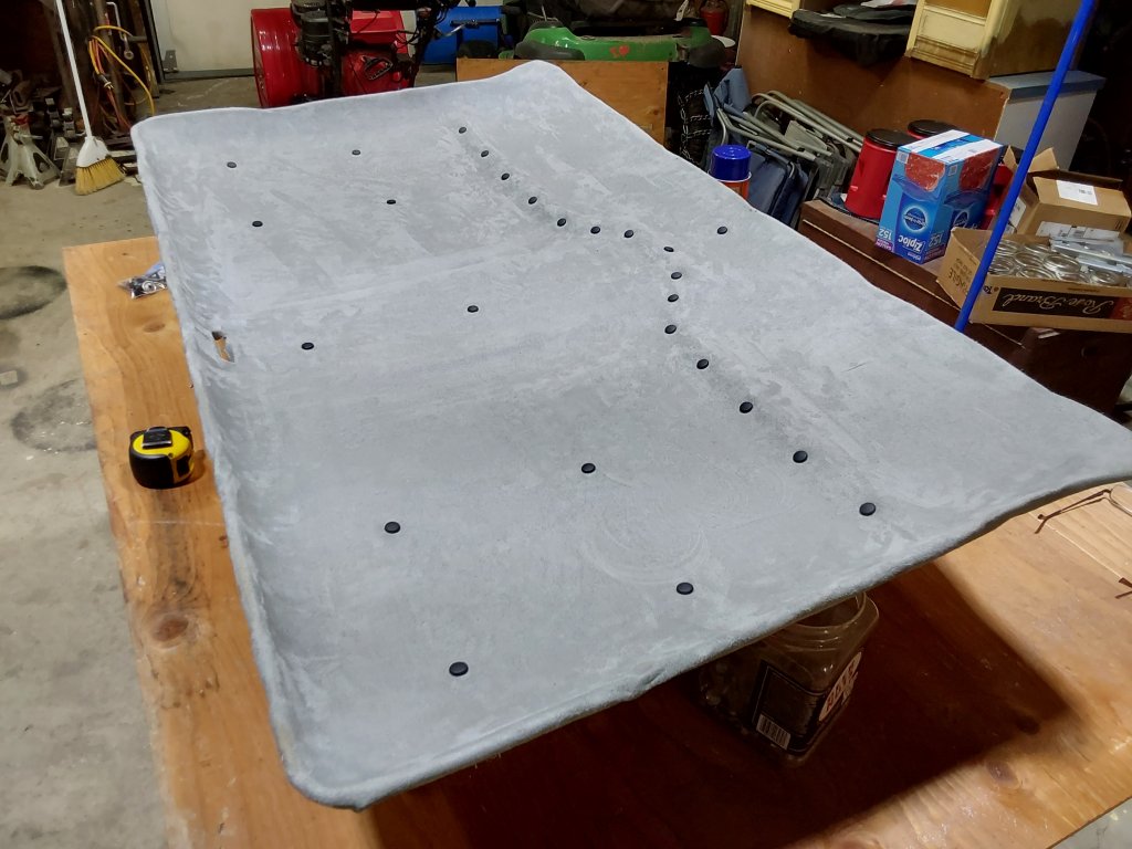

I just replaced my headliner. I used the old board as it was in decent shape. I spent time getting all the old crud off the board so the glue would have a solid surface to stick to. I used 3M 77 spray on adhesive from Lowe’s. I used a whole bottle which felt like too much but I’m glad I did because it didn’t soak through. The only cost I had was the adhesive. Had this fleece blanket in the house. Absolutely love it. Oh yeah, I put killmat on the ceiling first.

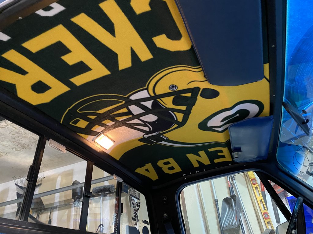

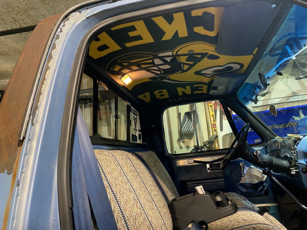

I just got done re covering mine in my 87.I used the permatex headliner spray glue,used 2 cans,cleaned and scraped all the old stuff off then shop vac any dust off. I used 3 coats of glue on both the backing and the fabric.after it dried I used upholstery pins to put thru the fabric and the backing to make sure it won't sag
