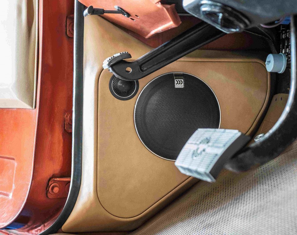

We recently installed a set of these kick panels from TPD hifi in my buddies truck. They come with Morel Nano speakers, sound amazing and no mods required.

Wow the TPD pieces are nice but definitely not cheap. Why are they $200 more for manual windows???

Yes, they are expensive but they are expensive speakers. Roughly $700-$800 of the cost is wrapped up into the speakers. Over the years I've been in both the audio business and the restoration business. I have built custom kick panels the old fashioned way on a router table with templates, fiberglass and filler and just based on "hours" billed I don't think any came in under $1200 (not including the speakers). Then you have to upholster them, which I would do myself to save money because the upholstery shop wanted $200-$400 to wrap them. Now you're roughly at the same cost with a set of $99 coaxials and they still won't clear the parking brake.
Morels are incredible. They don't sacrifice sound even with the shallow woofer. For the level of speaker they are, they are a bargain. Most speakers in this category are $700 - $1000.
For someone that just wants some background noise, sure there are less expensive options, but if the listener or the build warrant a good kick panel speaker, these are hard to beat.

Hi there, that was an error on our part our 2 ways are $1399 and our 3 ways are $1599 regardless of electric or manual windows.
