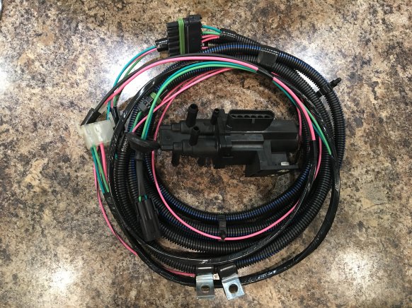

I have an LS dual tank harness using a Pollak valve rated at 65 psi. My harness kit utilizes a main IGN control relay which triggers the selector switch and it flips a LH or RH electric pump. Walbro makes a nice fuel pump to add to your stock 87 TBI sending units. Relays mount underdash near fusepanel and everything else wiring wise is updated to run dual electric pumps.
I offer the harnesses for $289 if interested.

Here's another pic....

Looks good. But what kind of fuel lines does it require?

Stock 6 port valve is ok in LS service. I am currently running this setup right now with no issues. I used earls fuel injection hose where needed with fuel injection hose clamps. 4 months, so far so good.
