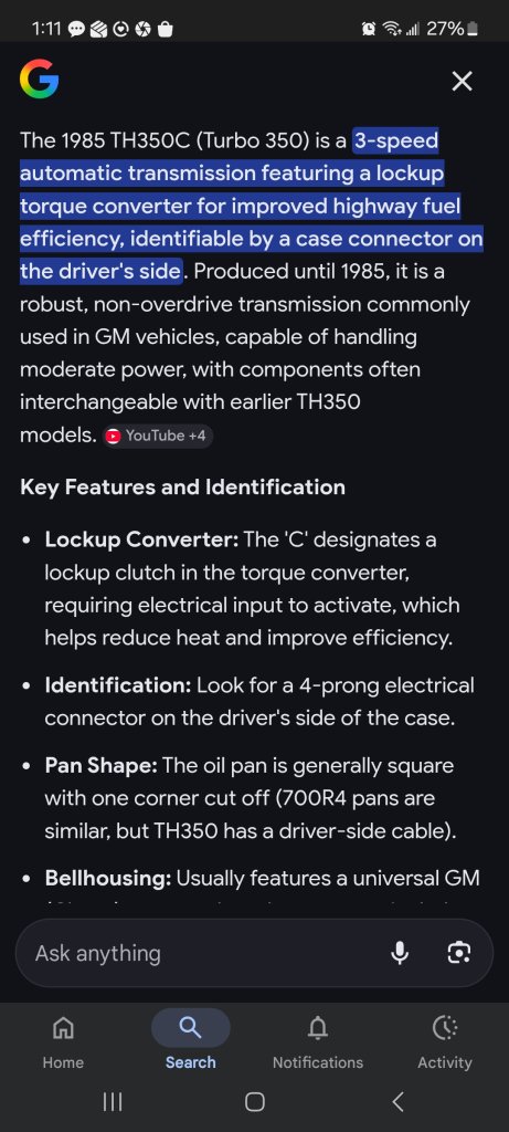

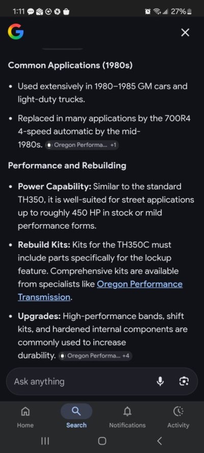

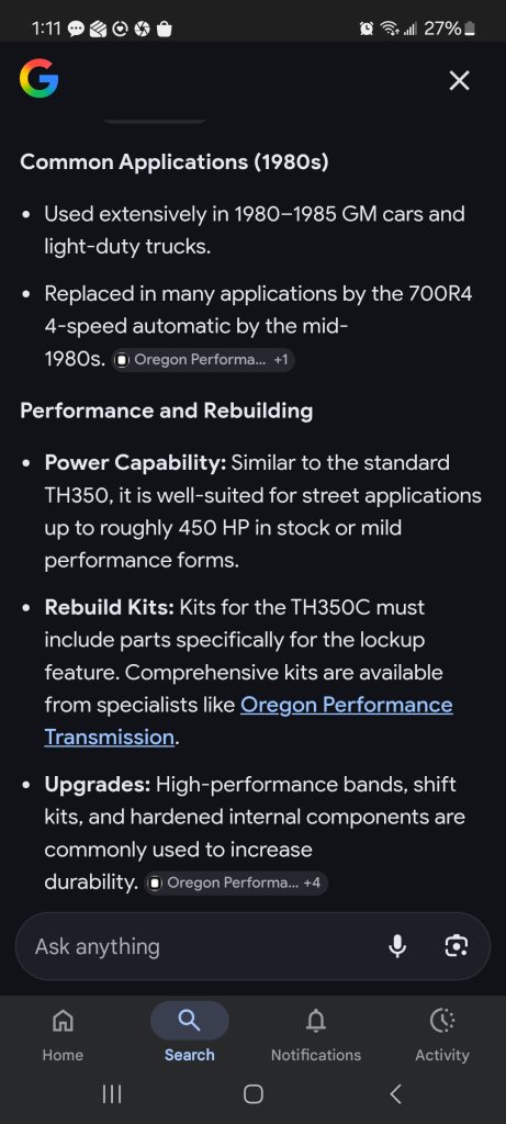

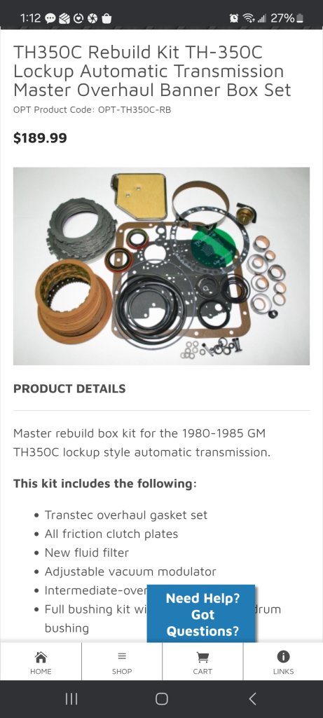

Where ever you were looking up parts messed up.

I almost asked where the hell you were rebuild kit shopping that a TH350C banner kit cost near $200, o_O then I got a better look and realized it was a master kit.:rotflmao:Oops.
I got a banner kit for $100, now I just need a half-decent core to build then I'll have me a spare.

This is what comes up when I search last year for the TH350C in C10 trucks. I could swear I read somewhere else that said 83' was the last year. I wonder where the hell that (apparent) piece of misinformation got started? :think:
