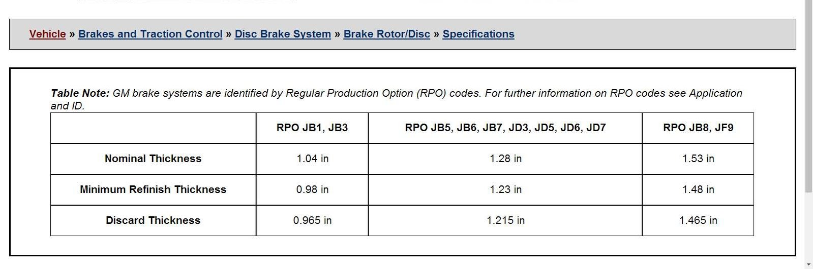

Rotor thickness specs (as new, minimum machinable, and discard) for the various JB classes:

See the post directly above for the thickness below which they cannot be machined. Also the minimum thickness for machining should be stamped somewhere on the rotor.

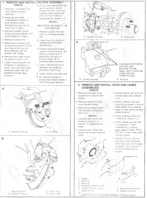

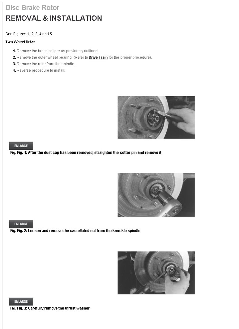

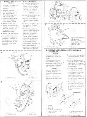

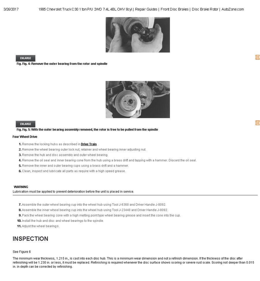

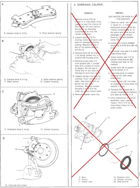

Below is some info on 1985 C30 front brake maintenance. I hope they are legible.
Caliper R & R and brake pad renewal:
Rotor R & R:
