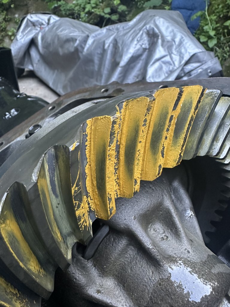

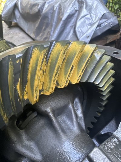

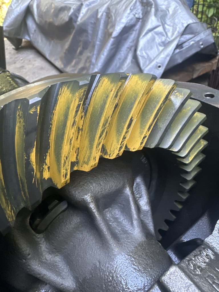

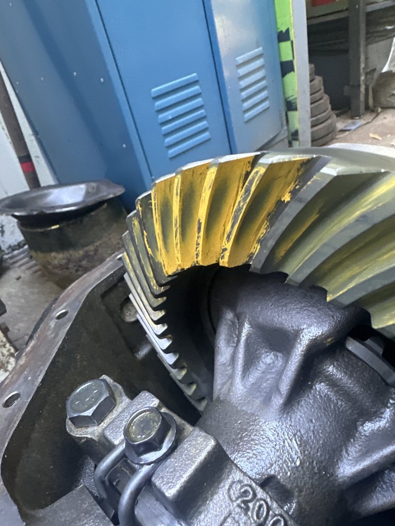

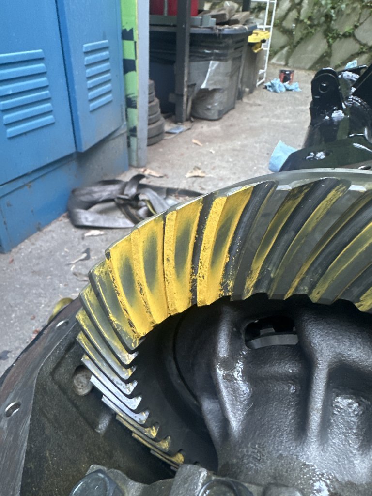

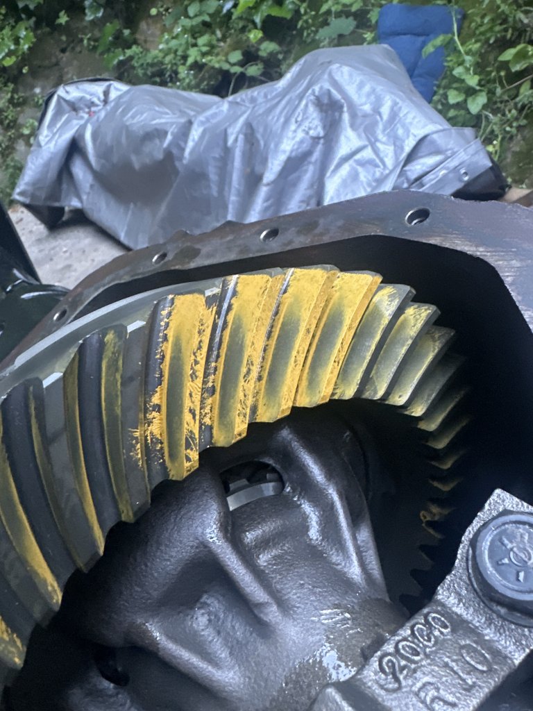

Is this a good pattern for gm 14 bolt ff?
blairsj
Dec 23, 2023
20
Steven
k5 Blazer
5.7 Tbi v8
Is this a good pattern for a GM 14 bolt FF?

Spencer
Not sure yet.
The pinion looks to be too deep. Compare your first image to the bottom right of this screen shot:
