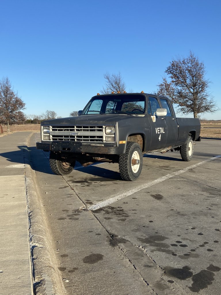

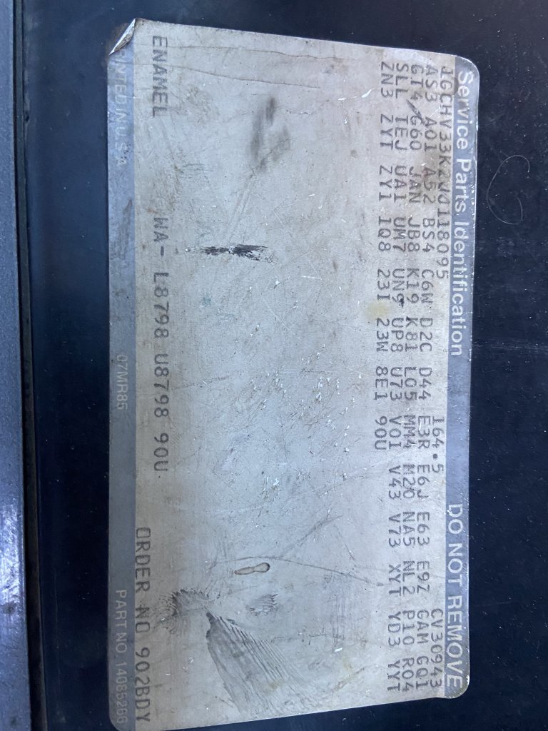

As requested….new truck about an hour into the trip from MO. RPOs . Old truck out for a stroll.
New rig looks tough!
