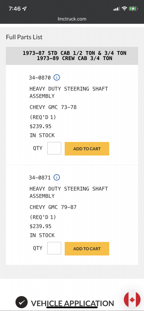

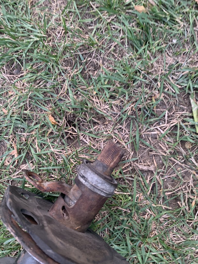

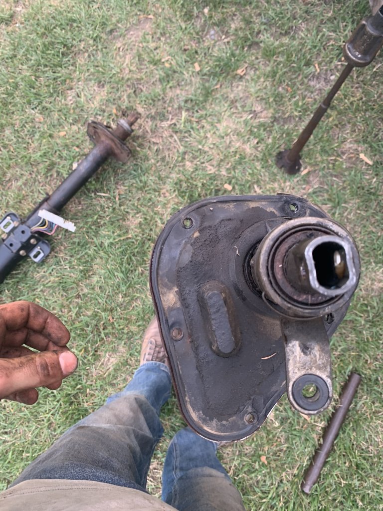

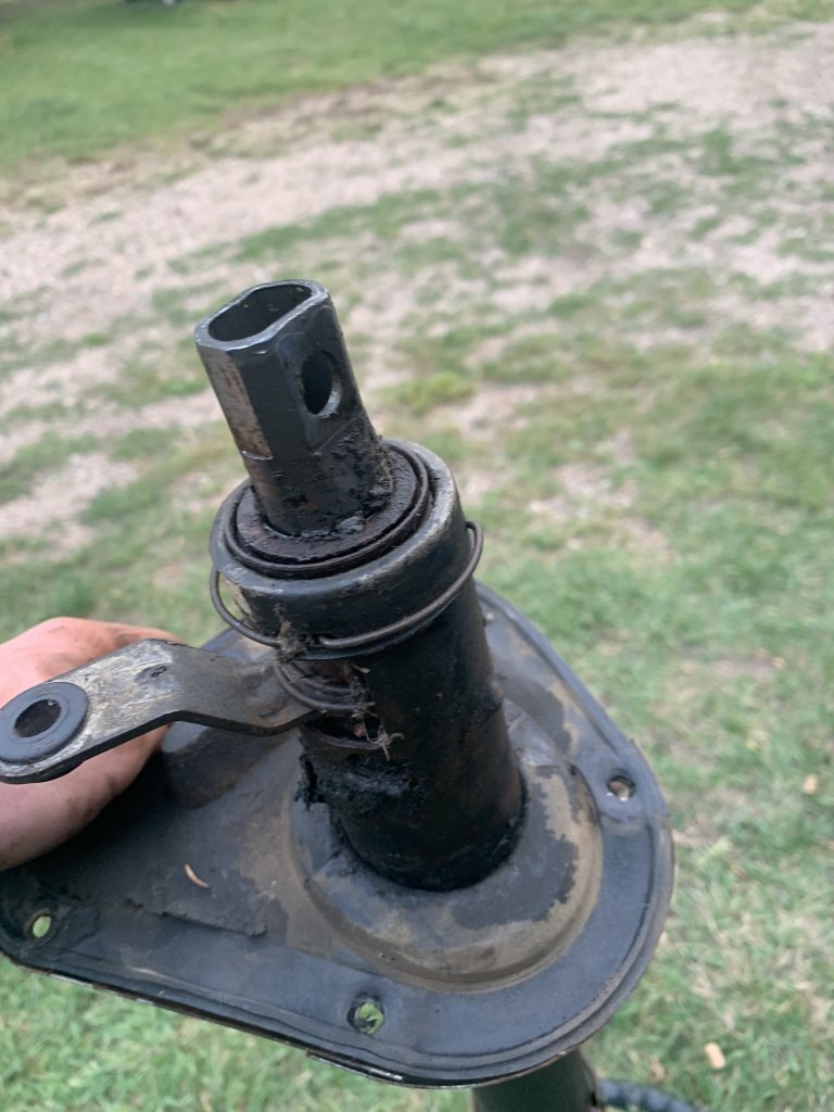

Hi I have a steering column for my truck but it has the splined end and my old steering column has the DD end for it so I have been looking for a intermediate shaft that would work with a spine and rag joint but can’t seem to find one am a just not great at looking or is there not many I found two on LMC truck but am not sure which one it would be I’m not sure the year of the steering column just that it’s from 73-79 c10 and it’s a tilt the truck is a 79 c20 not sure if anyone could help but it would be appreciated I do also have a picture from lmc if it is one of those
