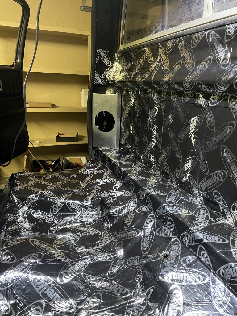

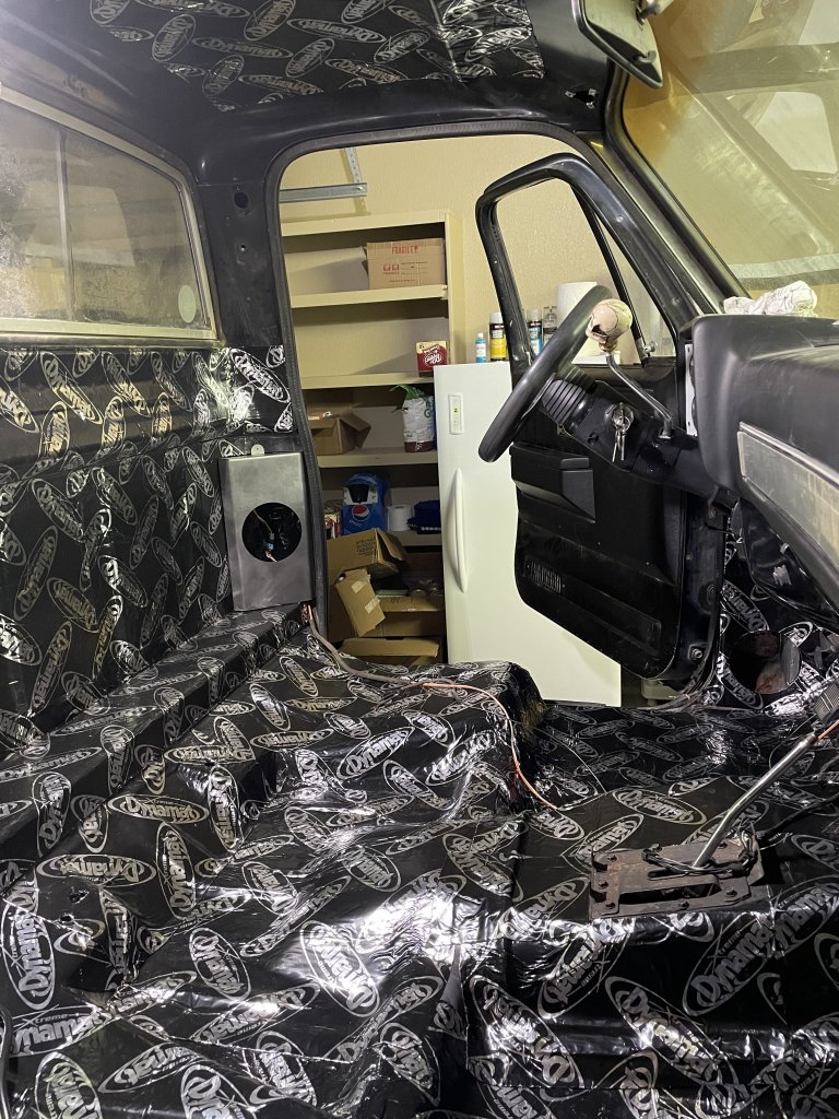

A couple of you guys are making me and my single layer of expensive Dynamat feel like chopped liver, lol
My single layer did wonders for heat and sound. Does very well. I also only did the floor in the drivers area of my burb so far, I also have the tape I need to put down yet.
Brought the inside temps way down with the dynamat and vinyl floor in the front. I expect a big temp drop when I finish the floor and put some foam down and some kind of covering in the back section. The roof of course too.
I went with dynamat because they've been doing this forever, they were the first I ever heard of with this type of insulation. No smell, great stuff.

Same here. It's encouraging to hear what a difference it's made. I've only ever used it for stereo sound in the doors of a new at the time 08 Dodge Megacab and it made a really big difference in something that was already really quiet.
I may need to Dynamat my wing windows and the rear slider :laughing1:
