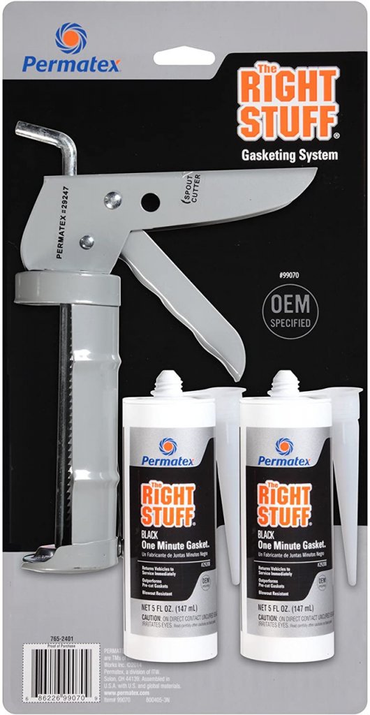

Hands down the absolute best gasket sealer ever invented.
Seals better, dries faster, and lasts forever.
I have used it to successfully patch slashed sidewalls on off road tires and it held up 100%.
If you this product on a clean dry surface, it will NEVER leak.
For valve cover gaskets, you can bolt them on and run the engine right away, no need to even let it dry!
No, I don't own stock in the company. I'm just a huge fan of the product.
NOTE: Cram a bolt in the tip of the tube when its not being used. If let open, the tube will turn into a tube of solid rubber.

I was going to suggest the same thing as edelbrock. Right stuff will be ready to use in 90 minutes. Use the same process as you have for regular RTV, but it will be fully cured and ready to go same day.

For me I'm good with any black or gray for use as valley seal in the manifold. But the right stuff is a cut above the regular stuff as the others have said and if I needed to get the truck back in service the same day that's what I'd use as well. However don't under estimate the amount of time it'll take you to do the intake manifold.

The biggest downfall is it's expensive. At the shop we have regular black and gray. That's our go to one or the other of those. And we also have gray right stuff. The biggest difference between the gray and the black is gray has more adhesive in it. So gray right stuff is what we use on harder to seal stuff or when we need to put it on thick and have it dry a bit quicker. It's good stuff for sure.

I believe the instructions say apply the sealer, then immediately set the other part in place and allow to set up for ~15-30 minutes(read the instructions yourself because my memory sucks). Then torque to spec. It basically evens everything out and adheres to the two parts evenly when you set it in place loose, then hardens the outer shell up enough to make an oring type effect for when you torque it down. I especially like it for diff covers that are notorious for leaking. Right stuff will keep it sealed up tight forever.

No, makes sure the parts are clean and assemble immediately. As far as I know the only seals with tack up times left are going to be the like the old blue stuff and honestly there is no reason to be using that anymore. Regular black, gray and right stuff is just light years ahead.
Also, how difficult will removing the intake later be (if I have to)?
Won't make it any harder.
