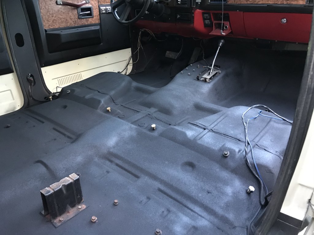

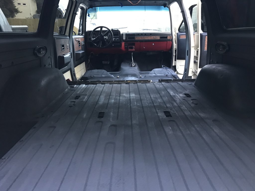

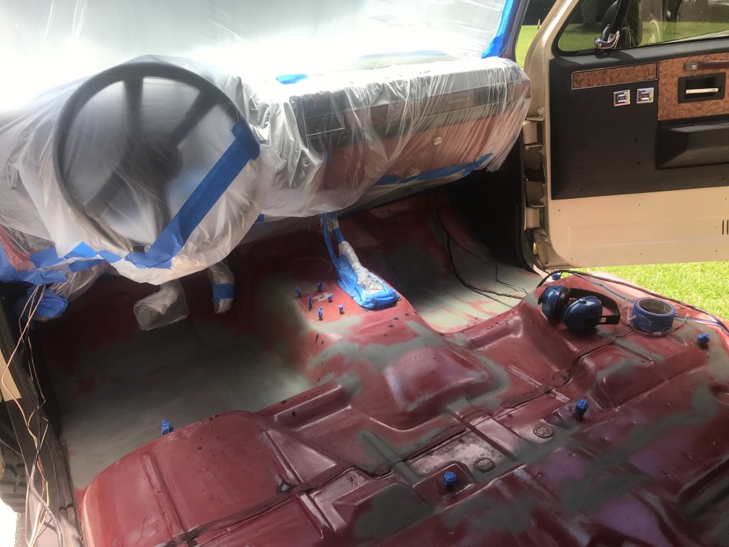

I used lizard skin on the floors and ceiling. Nasty job but worked really well. Had to add some heat shielding along the fire wall and trans tunnel. Relatively quiet….quieter and can almost hear the radio now!
