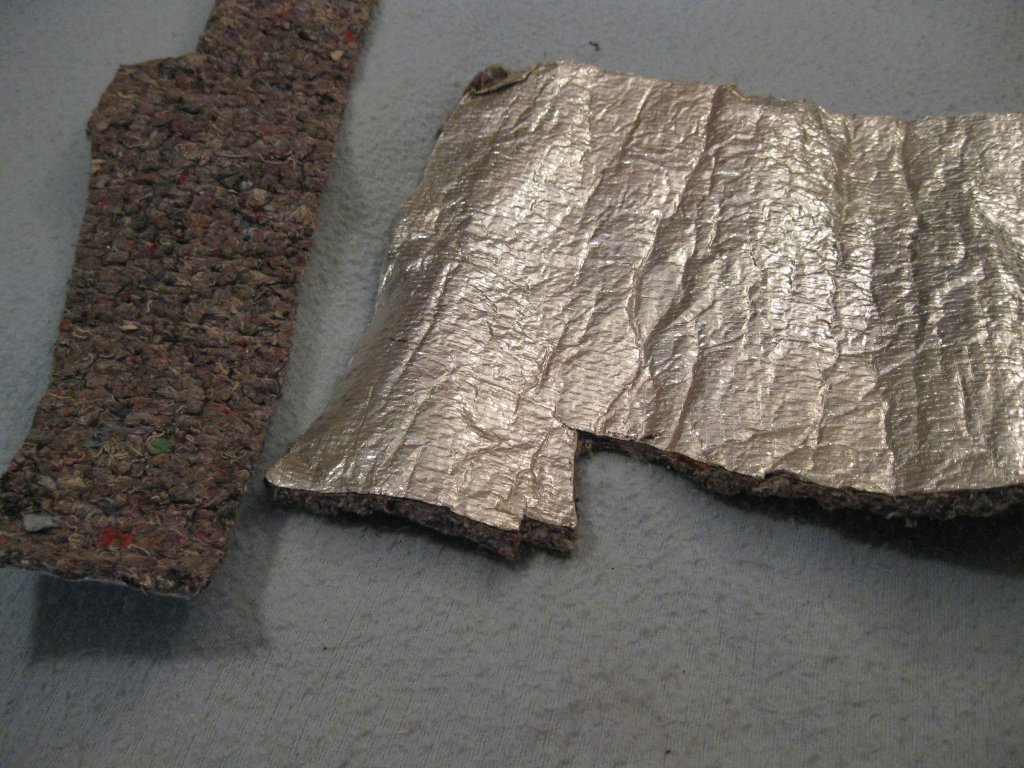

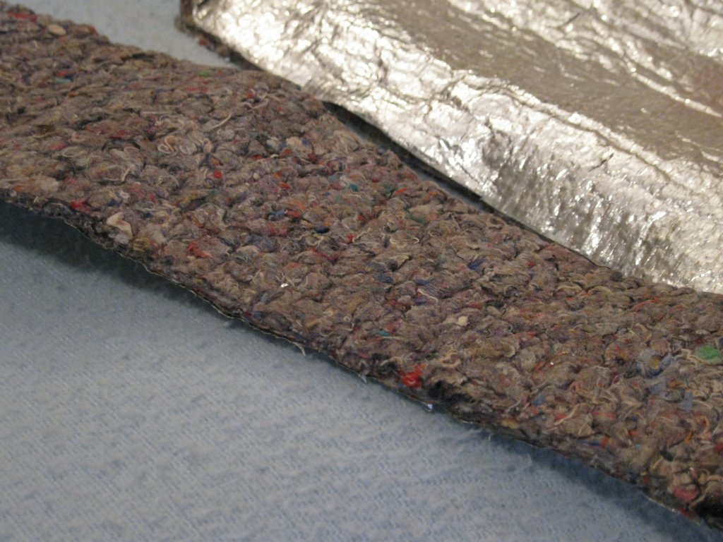

@RustCollector,
When I rebuilt my truck I used this jute stuff with a foil backing. It worked real well in both sound deadening and blocking heat. It jute was 3/8" thick. Now there were two different types back then, you could get the kind that had foil backing on both sides and obviously had the jute in between, or like I had with just the one side foil covered.

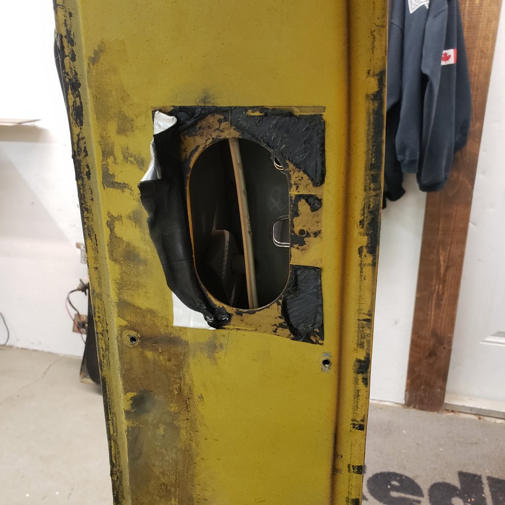

So Kilmat users, I def wanna use this in my C10, but I will evenbtually need to replace one, maybe two rockers. They aren't bad. And I wanna do a frame off resto eventually too. Should I wait to do the Kilmat, or just throw it on with some carpet and enjoy the truck for a few years before i have the funds to tear it apart?? I dont image I will need to remove the Kilmat for the resto, and I will put POR15 or eastwood paint underneath before laying it all down.
Thanks!
Originalthor
Aug 22, 2021
1,092
3,683
Saskatoon Saskatchewan
Scott
1989
Suburban
Kilmat does not peel off at all nicely. I needed to get at my bolts for the door hinges it was a struggle to get it to this point. If I were you I would do as much as you can and leave out the spots you want to repair in the future.
