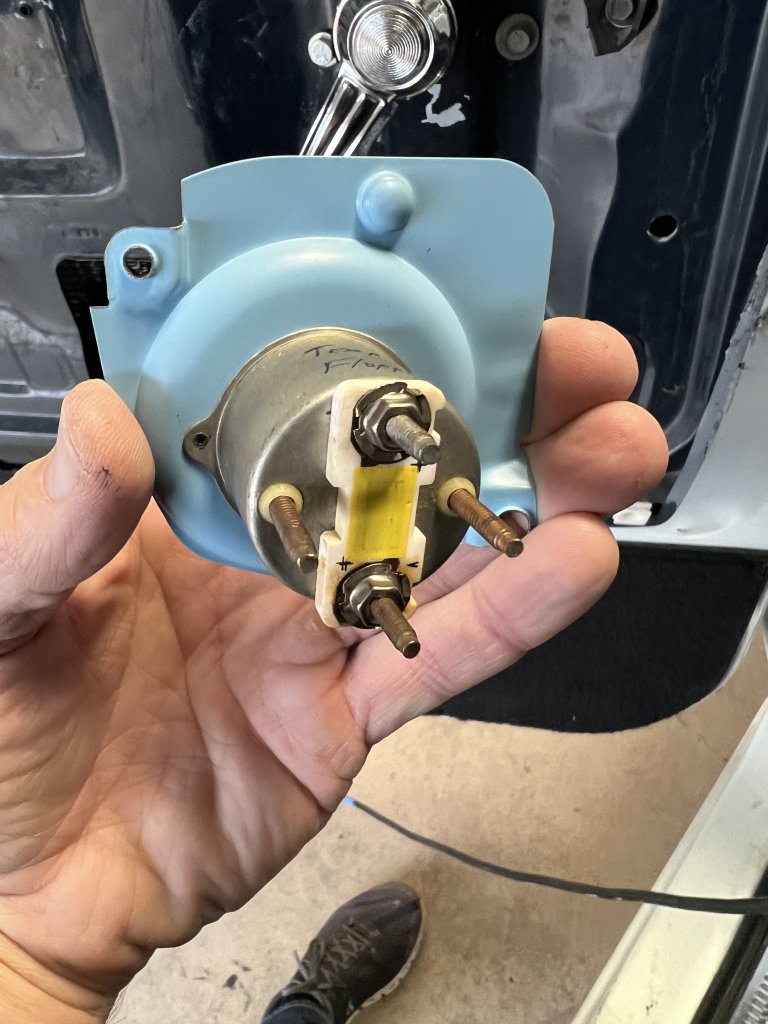

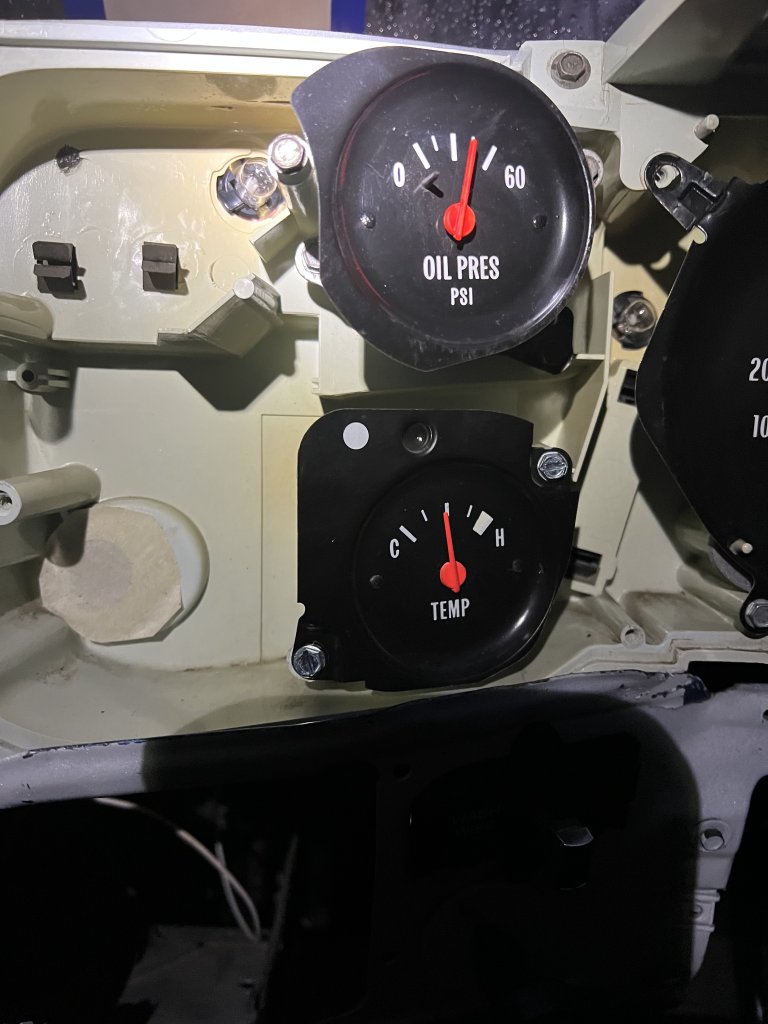

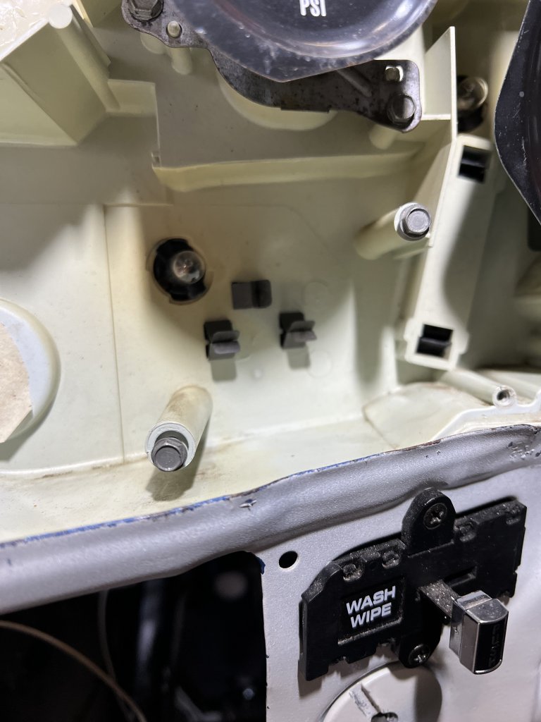

However, I was reading 12 volts at the positive contact where the amp meter plugs in.. wonder if I buy a volt meter and just stick it in there will it read volts even though it has 3 contacts on the back of the gauge and amp meter only has 2? Any ideas y’all?
temp gauge had 4 terminals on the back but cluster only had 3 contacts and it works fine. Any ideas?
No. The amp gauge is wired to have the full amperage of the truck flow through, the voltage gauge needs a ground and a positive

Well, I see what you’re saying. I think I will order the new amp gauge and call it done! Only way I get 12V is positive contact in cluster and chassis ground. Thanks @AuroraGirl

Okay, I'll throw my bit in here, as I have worked with both the 73-75 ammeter and the 76-up voltmeter. You *can* get the ammeter to work, and work safely, but it's usually really time consuming to make one display what your charging system is doing somewhat accurately; they tend to only twitch the needle a tiny bit one direction or the other out of the box. These are a shunted ammeter, so only a tiny bit of the current flowing through the electrical system passes through the ammeter, while the rest bypasses it and travels trough the main wiring harness. -i.e. let's just use 100 amps as a nice, round figure... 1 amp will travel through the ammeter while the other 99 pass through the main wiring harness. In reality, full scale on these ammeters is usually about 60 amps. By the way, you can flick that ammeter needle around so the pointer sticks up instead of down.
It looks like you started out with a voltmeter cluster, and are planning on installing the different cluster with an ammeter? Did you get the ammeter harness from the donor vehicle, or install a new one? That will have two rubber fuse holders containing those little stubby SFE 4 amp fuses, one on each side of the ammeter circuit... those are a must.
A voltmeter can be installed, and wired off of the temperature gauge... the voltmeter only uses two of its three terminals, though one of them (the ground) is on top instead of being arranged side by side like in your ammeter cluster. If going that route though, it might be easiest to just score a cluster and printed circuit that are already set up for a voltmeter.

Read Ellie Miner’s post carefully - the shunted ammeter design in the Squarebody does not send the entire current flow through the dash, and it is not dangerous. It also has two small fuses in the wiring harness under the hood to protect it. However, it is measuring the voltage from two different points in the wiring harness and using that to mechanically “calculate” the current flow.
The accuracy of a shunted ammeter depends on the shunt being a known resistance value, and then measuring the small voltage change on each side of the shunt. However, the squarebody resistance will change as the wiring harness gets old. Overall, the voltmeter will be more useful.
I converted my truck from ammeter to voltmeter, using a new voltmeter from LMC. It’s a simple conversion, but I couldn’t point you to the internet article I found and used.

@Ellie Niner and @75gmck25 i have found the internet link to do the conversion but decided it’s too much work at this point. Cluster came in original truck with amp meter and when I tried to test gauge out of truck I did not put it in line correctly so I think I cooked it. I’m just going to put a new one in there and be done.

You are seeing +12 volts at both terminals for the ammeter, yes? If one is grounded, you'll probably pop the new gauge... More common to have one open circuit due to a blown inline fuse.
