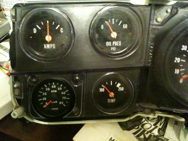

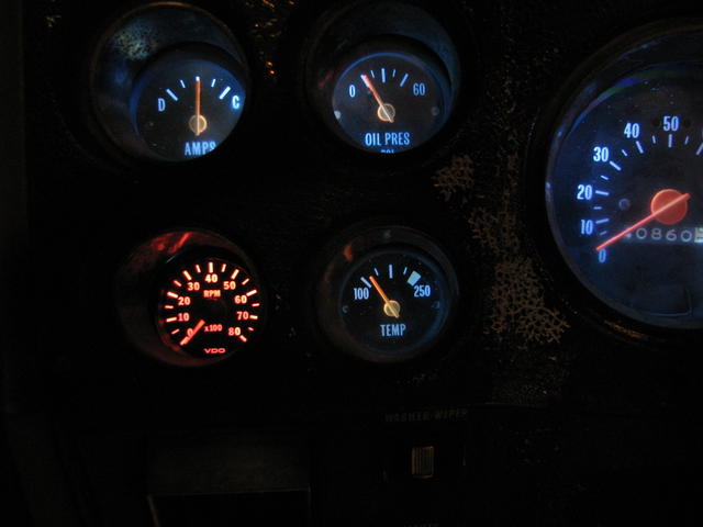

Small tach in lower left corner. It was just a bit brighter than the rest of the gauges using factory back lights.

@SlickGTP install pics...
I see yevgenievich posted some pics too. Looks nice! I was real close to going this route also.
