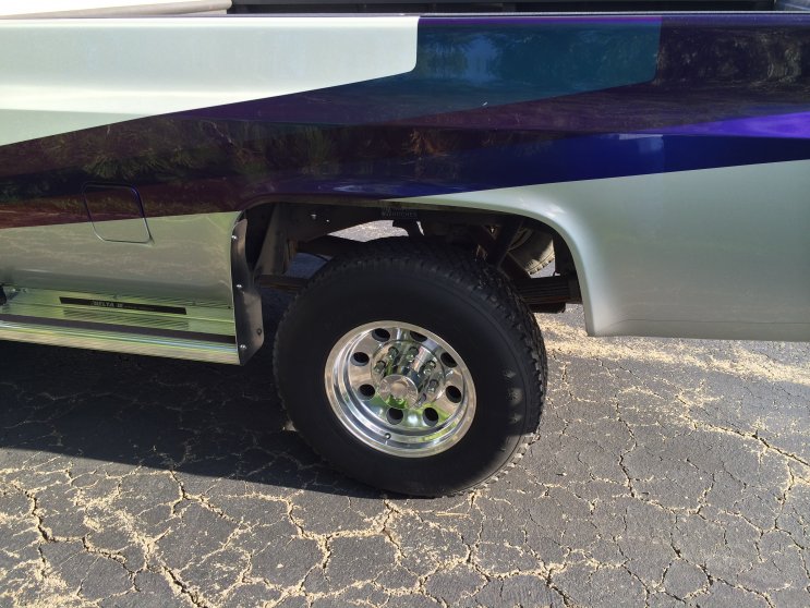

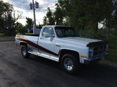

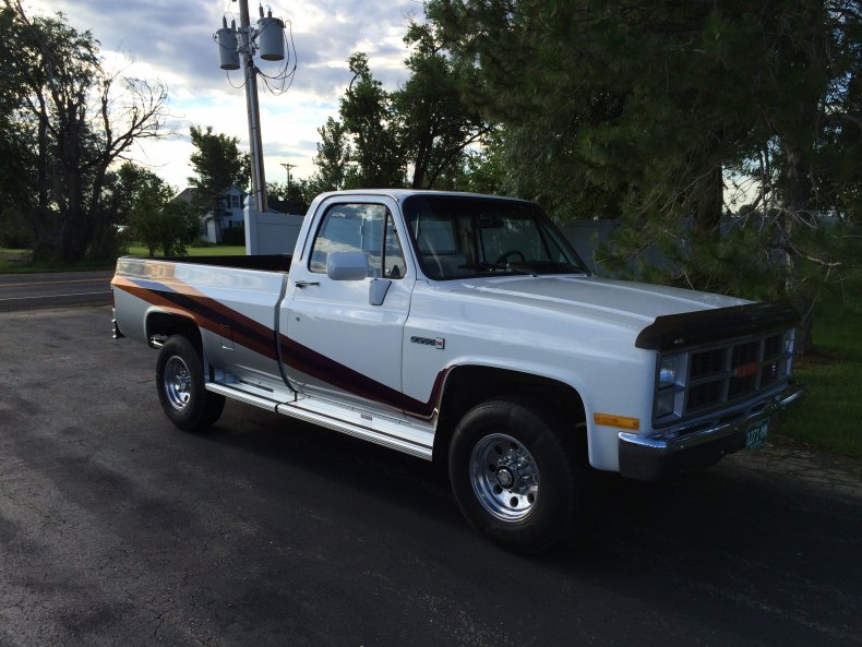

So next on my list is leaning the carb a bit more.... another post for another day. Thanks everyone for your help this last weekend, you helped me get this truck to running as sweet as I think it looks..... :) Controlled pearl base paints prove you really can make a pig look better with lipstick!
