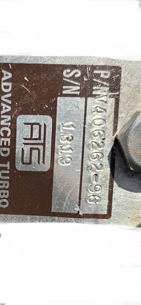

Thank you sir
I was able to find this on it

Thank you sir
Minus the letters and plus a couple of numbers, that's a Garrett AiResearch part number.
The one on mine is probably the same, but I'll try to double -check it for you.
As long as it's operating correctly, forget trying to hot-rod it. The engine just isn't strong enough to go racing.

Your part number doesn't cross in Garrett, but mine has 408105-5115 on it, which comes up as the cartridge or CHRA (Center Housing Rotating Assembly) so you may still be able to get the moving parts. It shows as a T04B20 model. An overhaul kit for that should be available as well.
