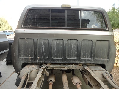

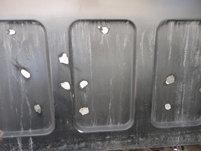

Here are a few attachments of pictures before.

A good wire feed welder and a flap disc on a 4" grinder will make quick work of those small holes. Good luck.

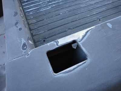

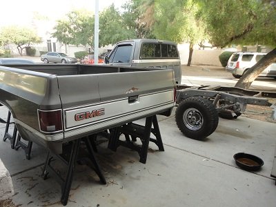

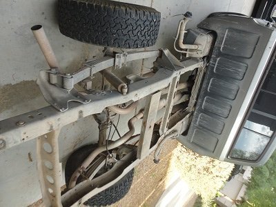

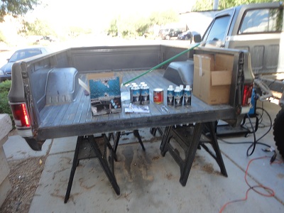

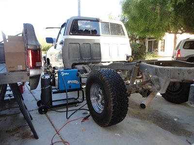

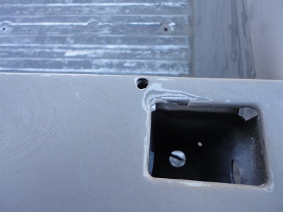

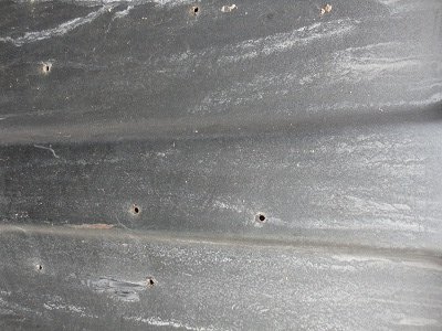

Got all the cab holes filled.
Got a few bed holes filled.
The bed is now sanded and ready for some bed liner
the frame has been worked and is ready for POR15
I've decided to get rid of the gooseneck hole in the bed but will keep the channel on the frame cause at least it provides extra strength.

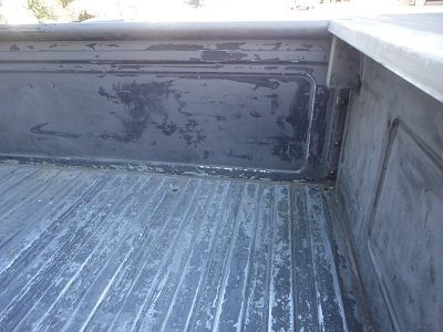

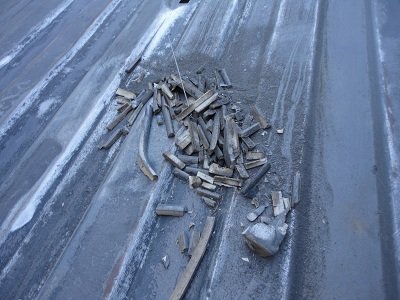

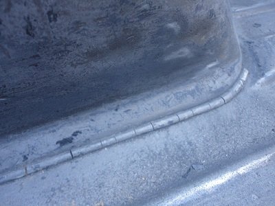

The seam sealant on the bed was old and cracked so I took a chisel and broke it all out. I will be replacing with some Norton's quick set firm seam sealer.

I feel your pain. When I got my truck it had over 40 holes to weld up. Most were on the bed rails where tool boxes once were and not to metion a roll bar at one time. You are taking all of the right steps to restoring this truck. The more time you take right now to do it right, will make you happen in the end.
47,210
9,482
Are you going to do a spray in bed liner? I'd imagine just leaving it clean, the bed liner will seal it pretty good.
