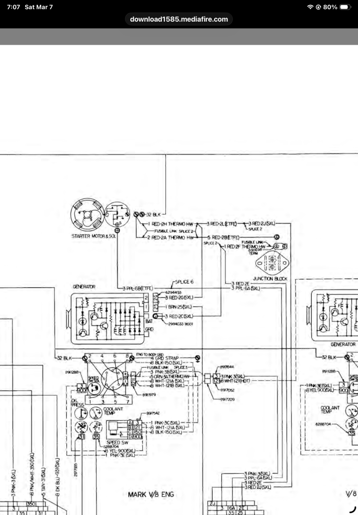

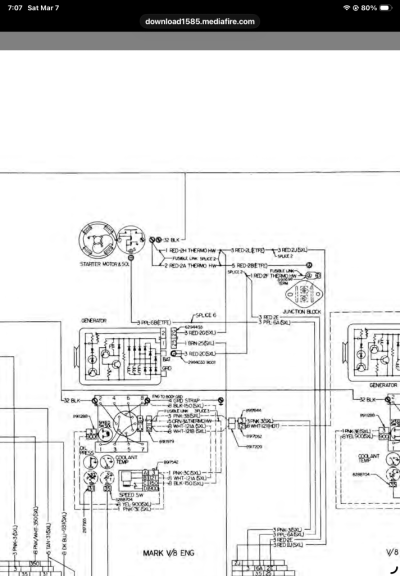

There are electrical schematics for almost every year truck here on the Forum, most are the same in many areas.
This is a small pic of the one for an '80
It shows where the Fusible Links are in the wiring

Gotta “love” fusible links… When the 85’s alternator failed, it sent such a strong surge it fried the ignition switch, fusible links AND the starter… Even the bigger wire off the alternator melted.
Start chasing wires. Something melted, should have fusible link/s at the starter harness and off the firewall “2 post with little dogbone connecting them” junction block. If you can’t see the failed one, you will feel it… Gently pull each fusible link run, the “mushy” section is your failed as it should wire. NAPA and Carquest both carry new sections to splice in.
DO NOT replace with an inline mega fuse or circuit breaker. As much as I’d prefer those, they take longer to fail, and you risk burning your truck down. That particular “fix” cost my Uncle Bob a really clean 1968 C20…
