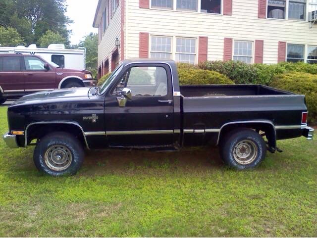

Picked up an 85 k10 for parts.What I can't figure out is why the buzzer won't work when the door is open or key is turned to the on position.My 87 did it
